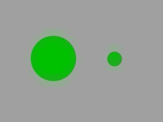

  11. AviSynth:
    ChromaShift() #shift chroma
    MergeChroma(awarpsharp2(depth=48)) #sharpen chroma
    Original image:
    After blurring and shifting of colors (common with VHS):
    Fixed with ChromaShift(c=-12,l=-4) and MergeChroma(awarpsharp2(depth=64)):
