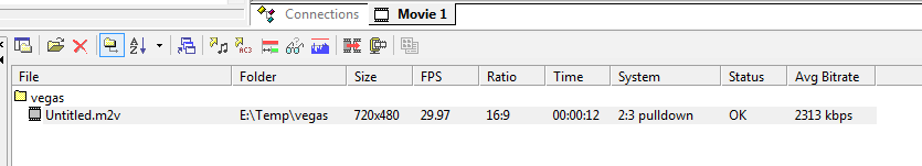

  13. aBigMeanie aedipuss's Avatar
    Oct 2005
    666th portal
    not sure what's wrong at your end but dvdlab pro 2.51 opens and uses vegas pro10 23.97w/3:2 pulldown renders just fine here.
