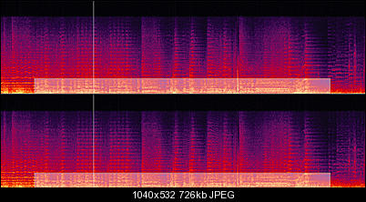

  1. I was wondering if there was any way to select a small portion of on audio file (while viewing its spectral frequency) and apply a center channel remover to remove the center channel from only that portion? Can this be done with Sound Forge? I prefer to use iZotope Vocal Remover. Below is a picture of what I am speaking about. I only want to remove the center channel from the selection.
Name:	Adobe Audition Selection.jpg
    Also, my Adobe Audition 3.0 isn't displaying any of the center channel extraction tools. "Vocal Remove" is listed under "Favorites" but it is grayed out. I reinstalled the program, but the tools still aren't there. Anyone know why? Thank you!
