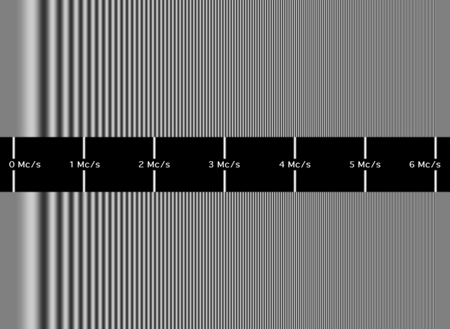

    I used a test image from this website which tests high frequency luma signal handling. If I understand the interference problem correctly, this should be the ultimate test.
    Here is the original image:

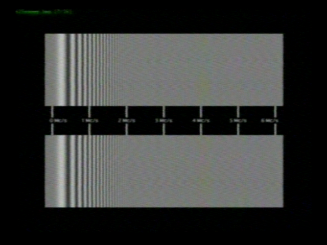

    And here is the image sent to the VCR using the S-Video to Composite adapter and captured from the VHS using my video capture card:

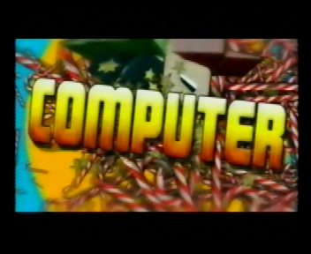

    Some of the noise appears best (or worst) when shown in video, so here is the video. Mind you some of that interference may be unrelated.
    Forum Convert.avi

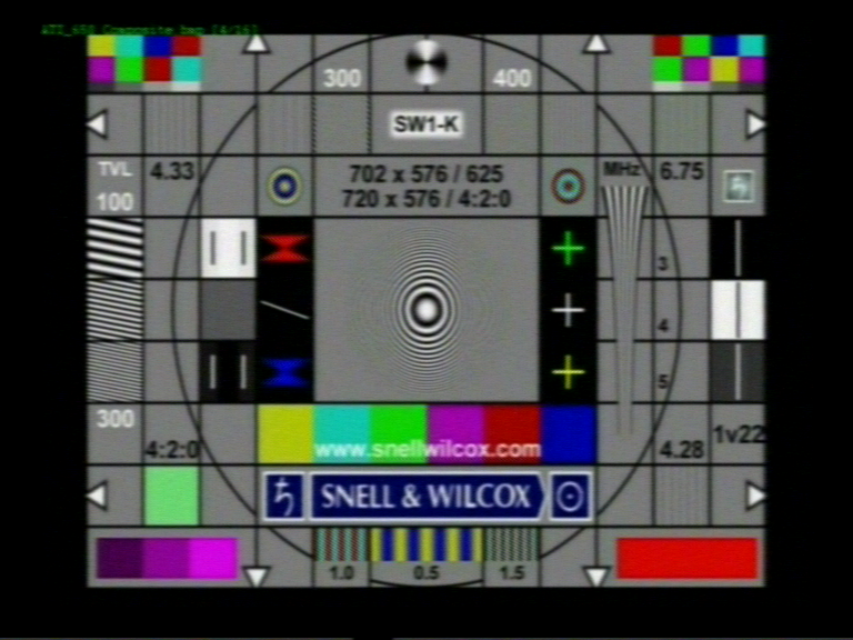

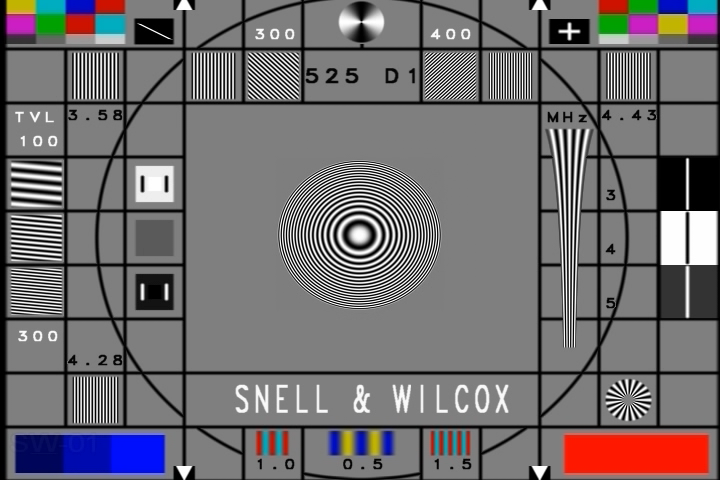

  15. Chroma/luma crosstalk doesn't show up much in perfectly vertical bars. Try this image:
    If you can find it, there's a video with a similar test pattern but the concentric circles in the middle move around. That's even more difficult for comb filters to handle.
    But the chroma/luma crosstalk problem is more a matter of the TV separating the chroma an luma. If the TV (or capture card) has a good 3d comb filter (few do) the false colors will be reduced.

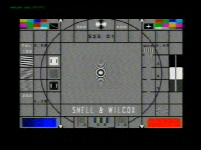

  16. Wish I could handle image uploads as well as you.
    Well I tested with that image you provided and to my eye the patterns where one might expect interference have simply disappeared. This could be the poor quality tape I'm using but all my others have things on them right now.
    Normal Video tends to look all right so I'll likely use this adapter unless someone jumps in front of me with a PCB for the other design.

  17. VHS has very low horizontal resolution -- about 360 lines across the entire frame. And the graphics card is probably using a deflicker filter which blurs the output vertically. So you have a resolution something like 360x300 on tape.
    What exactly are the sample image and video? The test pattern enlarged to full screen on the computer, output as s-video by the graphics card, converted to composite by the adapter, recorded onto VHS tape, then played back by the VHS deck, and captured by the computer? What do you see if you connect the composite signal directly to a TV? How does that compare to s-video connected to the TV (if you have a TV with s-video inputs).

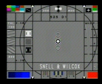

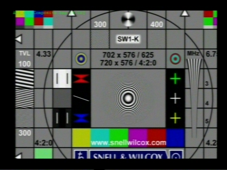

  20. OK, the driver has a setting for the "full screen device" which works as "theatre mode", however even with this is set and working, there is no way to change the S-Video resolution differently to the monitor resolution.
    By setting the monitor resolution to 640x480, I generated the attached images through VHS recording and they are certainly the best yet. First one is 352x288 (my usual VHS capture resolution), second is 640x480.
    When a similar test pattern is burned to a DVD it will look about like the images in this post (it depends on the TV too, eg, a typical 13" TV won't show as much detail as a good 32"):
    The TV I used before was a 13" CRT and I'm not all that motivated to move a larger one over to my PC.
    That image there was what I was expecting when I tried this, not that I'm going to complain.

  21. When you use theater mode the resolution you set the second device too doesn't matter. It will be adjusted to standard video resolutions.
    Ah, I didn't notice you were using PAL. In that case 640x480 wouldn't be correct. You'd want to set it to 768x576 and use a 576 line test pattern. But you may not be able to specify that resolution. And it's possible that the drivers actually give 1:1 pixel mapping using 800x600 (by cropping) since that's pretty close. You can use the ATI 650 sample image in the post I linked to earlier.

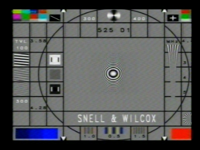

  22. The graphics card only inicates that it outputs 800x600 or 640x480 video, if I set the monitor to anything in between, it uses 640x480 and the screen pans to where your mouse pointer moves.
    Because of this I doubt that it would change this setting for the "theatre mode".
    I've included a couple of images taken of that test pattern at the two avalible resolutions, this time using VirtualDub recording video sent from the VCR live without first recording to tape. There is still an absence of any major interferrence.

  23. The 800x600 shot looks the best so far. The black borders look a little bigger than I would have expected. Do you have overscan compensation enabled in the graphics card's setup?
  24. The 800x600 shot looks the best so far.
    Are you sure you don't mean the 640x480 image above the 800x600 image, or is this conclusion given with consideration of other factors?
    Overscan or any other screen sizing adjustments are not available for the S-Video output from my graphics card. Playing a VHS tape recorded from TV, the image fills the screen so this can't be my capture card or VCR causing the borders.
  25. The resolution in the last 640x480 shot looks good -- but a lot of the right and bottom edges of the source image are cropped away. That's why I said the 800x600 shot looks better.
