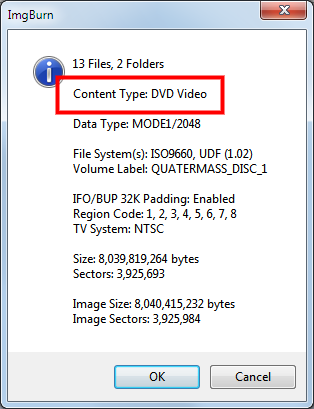

  3. Originally Posted by vladorlok View Post
    i tried to burn one with imgburn, by using 'build' and the audio and the video folder, but the result was an empty disc!
    Did the disc include the VIDEO_TS folder as well as the IFO, BUP, and VOB files? When you went to burn the disc did imgburn indicate it was going to make a DVD Video disc?

    Sorry jagabo...i must have been completely blind. Yes, it is a DVD Video i was going to make.
