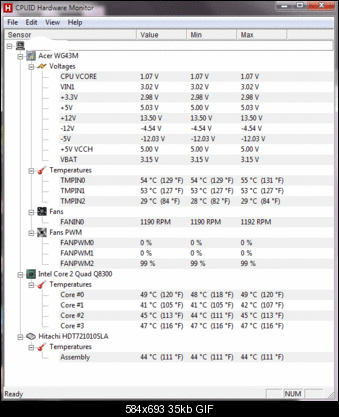

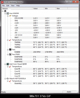

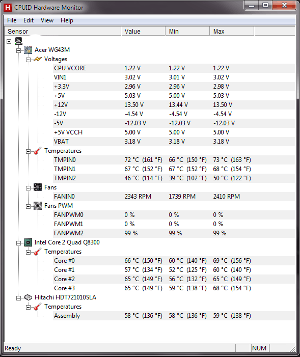

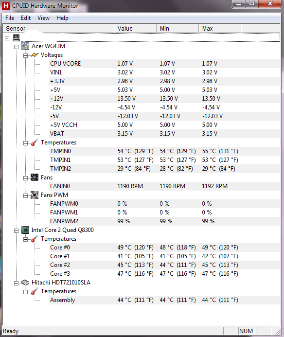

    here are screengrabs from cpuid hw monitor...
    just after restart:

    during playback errors:

    the temps and the fan rpm go up by some distance, but i've no idea if they're still within acceptable limits?
