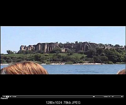

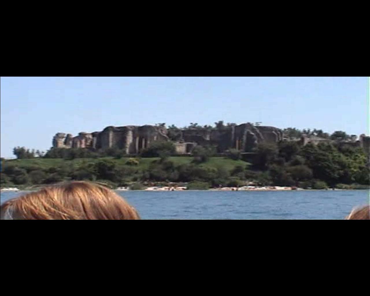

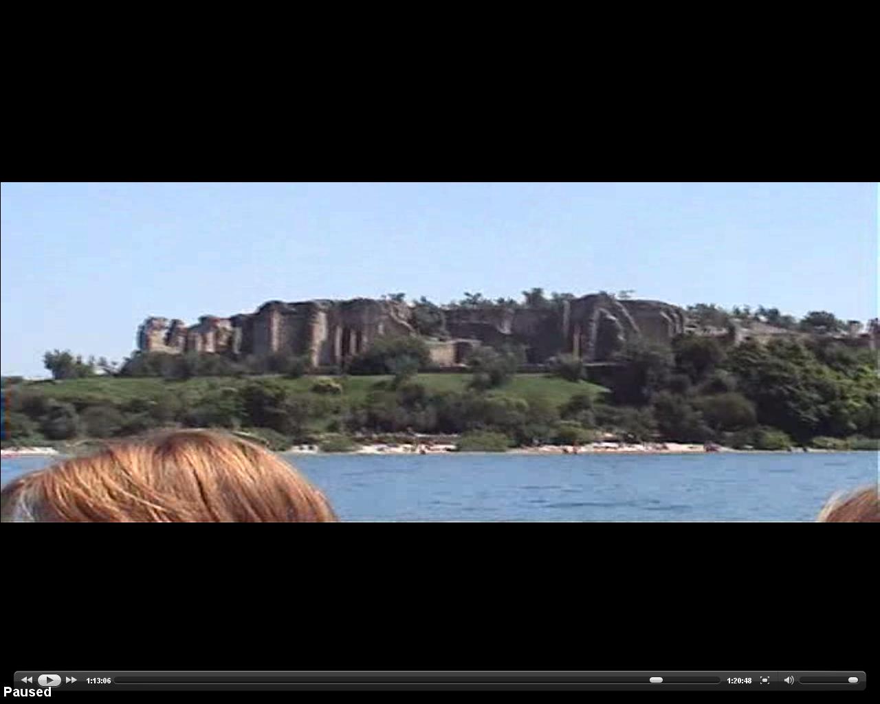

    Truthfully, I dont see much difference between films edited only with deinterlace and resized and with all other filters, when watching the film. I see difference when I screencapture the film
Name:	1-13-06-all filters.jpg
ID:	7943Click image for larger version
Name:	1-13-06 plain 2.JPG
    I have also added in this compilation of filters "sharpen" but then the picture is awful so i dont use it anymore.
    What filters do you recommend?
    How can I improve quality of my picture when filming movement?
    I would like to have clear, high quality picture in the end.
    Is there some other way to get high quality divx of 1.5 hours in size of 700 mb (another programe, another settings or ....?
    What am I doing wrong (maybe the order of filters or something else)?

  4. A tripod will offer the most dramatic improvement you will get, ESPECIALLY with movement and zooming. If you have not tried it, the difference is amazing. This will also contribute to better overall quality and filesize. Yes, I know it's a PITA.
    Other than that, try H.264 instead of Xvid.
  5. Shaky, noisy, handheld camcorder footage will not compress as well as Hollywood movies. You'll need to use a lot more bitrate, and hence, a much larger file. h.264 encoding will get you smaller files than Xvid. But it will take longer to encode and playback options are more limited.
  6. ok then, If I drop the idea of small file, what do you suggest?
    Do I stick with divx or do I make mpeg2? With which I will get a better picture?
    Do you have some instructions?
    Divx is useless for this.
    Use MPEG-2.
