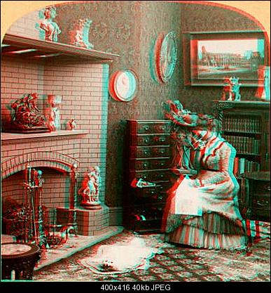

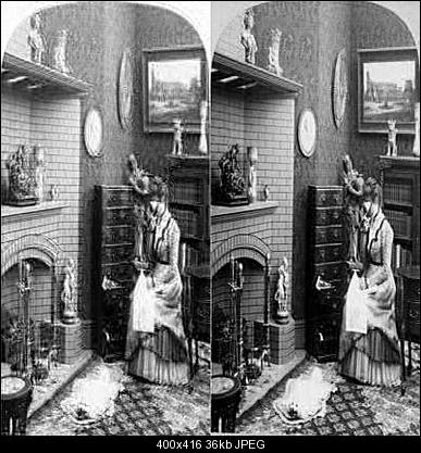

  3. Yes you can undo the anaglyph. It works better with grayscale anaglyphs (where the two images were first converted to grayscale, then anaglyphed) than with color anaglyph (where one image is created by subtracting the red, the other by subtracting the green and blue, then the two images are joined into an anaglyph).
    This AviSynth script will undo a grayscale anaglyp (back to two grayscale images) and put them side by side:
    ImageSource("anaglyph.jpg")
    left = ShowRed().BicubicResize(width/2, height)
    right = ShowGreen().BicubicResize(width/2, height)
    StackHorizontal(left,right)
    ShowRed() turns the red channel into a new grayscale image. ShowGreen() does the same for the green channel. Then the two images are stacked horizontally.
    grayscale anaglyph:
    side-by-side:
    Of course, you can do this with a video by substituting the correct source filter for ImageSource(). Ie, AviSource(), DirectShowSource(), etc. Then you encode with a stereo aware encoder.
