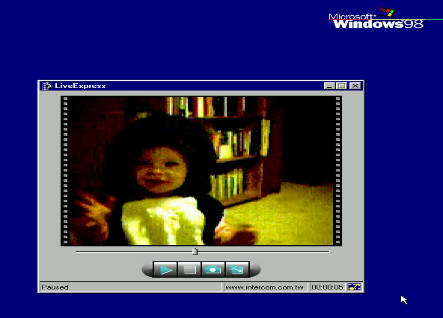

I have several of these video files.
In order to watch them I have a Windows98 VM on VirtualBox and I installed the logitech quickcam CD.
I saw your Halloween video. That's a nice costume!
[Attachment 55184 - Click to enlarge]Last edited by trs80; 2nd Oct 2020 at 18:19.
