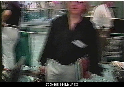

    The problem is the captures always look like they need to be de-interlaced.
    Here is a screen shot from one of the videos:
    If anyone has any tips on how to capture through the Dazzle so this doesn't occur I'd greatly appreciate it.

    you're capturing interlaced material. try capturing to DVavi or mpeg-2 interlaced. when playing back on vlc you may need to turn de-interlacing on for your progressive computer monitor.
