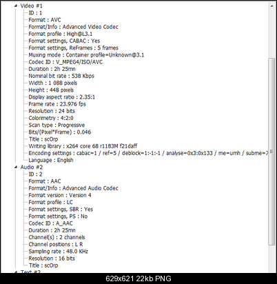

    Probably because you didn't give enough information.
    What format of audio and video? Some formats are much harder to edit than others. H.264, Xvid, Divx are a few.
    Some audio formats like MP3 VBR are also more difficult to edit.
    Was the audio and video synced before you cut out the one minute? Did you do your cuts on keyframes? (I Frames) Otherwise with some codecs you can have sync problems.

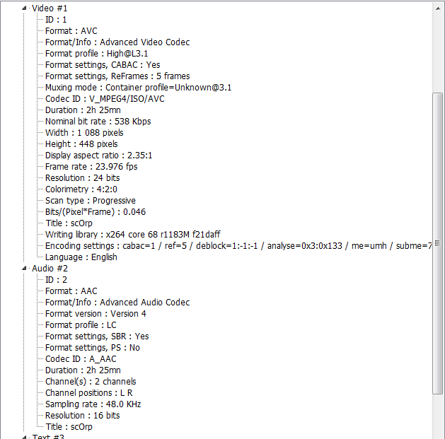

    info of videoClick image for larger version
