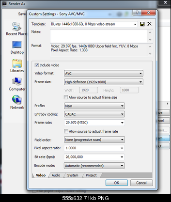

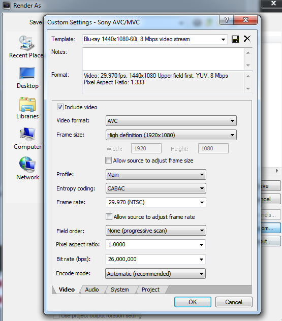

    the sony vegas pro 10 avc encoder can render at up to 26mbps and the mpeg-2 encoder can go up to 80mbps.

    Thanks Aedipuss
    I am using the trial version of Vegas 10, when I select 26 Mbps, it flags an error [an error of unknown cause], and when I try a different bitrate e.g 22 Mbps it would render the video but MediaInfo reported the bitrate was about 8 Mbps!
    Any help would be appreciated
