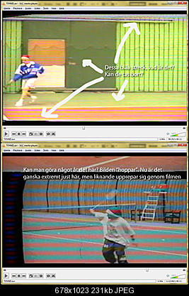

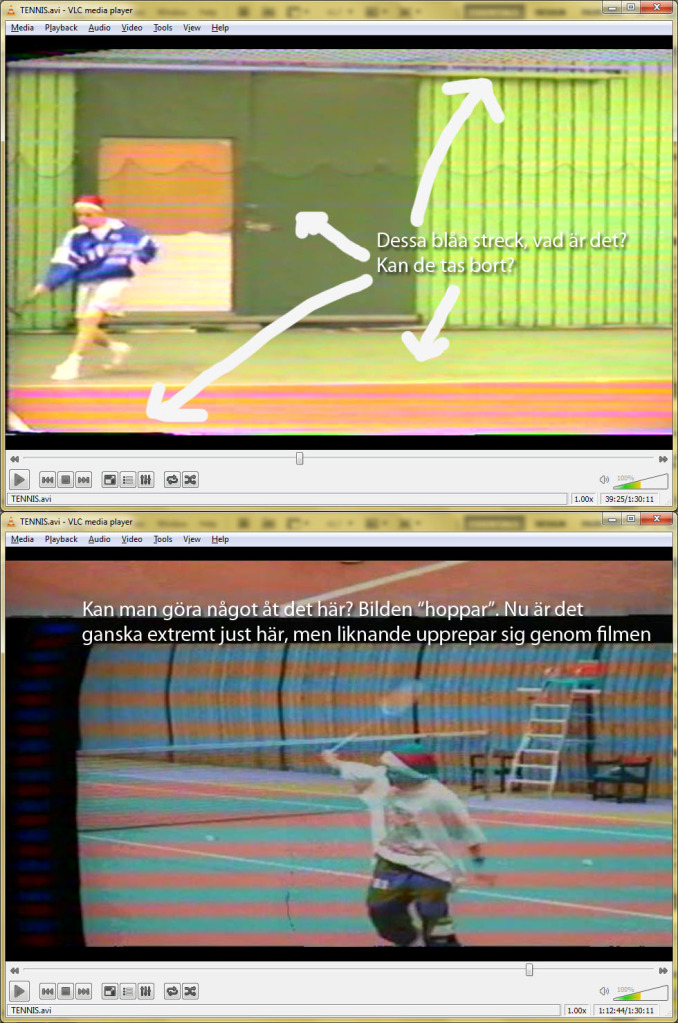

ID:	7945 Is this something I can get rid of? Have written in swedish, but should say that theese blue lines are during the whole video. and that the picture below is a worst case scenario, but as you se the image has split itself. Can I get rid of theese with some kind of filters?
    And I think I am going to test adobe premiere for capturing, ulead seems to be useless, the files are not big ether, not the 10-12gb/hour.

    These artifacts are not in the original capture in Ulead then you can not blame Ulead.
    You are editing/dubbing back to Mpeg2 in Pinnacle. That seems to be the culprit. Even so that should not happen unless you have used some obscure setting.
    But maybe they were in the original capture and you just did not notice them. Then the blame is entirely with easycap.
    I assume your OS is no later than XP as the version of Ulead you are using would have issues with Vista/Win7.
    Mpeg2 at 8,000 kbps is 4 gig per hour. If you want a higher quality then ditch that easycap and get a real capture card.
    10/12gig per hour suggests you have read something on here (or elsewhere) about DV. You would need an ADVC to capture in DV unless you have a DV camera and can do analogue pass-through with that
  28. Member

    The artifacts are in the raw-files from ulead aswell. And I am using windows 7 64bit, have the lates ulead program and drivers for windows 7. But maybe better to buy a new hardware. http://easycapexpertti.mybisi.com/product/easycap-dc60-v31b-video-capture-macxpvistawin7 a better choise, or do I need to get a Tv Out Graphic Card for this? I thought I could edit in pinnacle and save the video with same preferences, not losing quality.
  29. Member DB83's Avatar
    Jul 2007
    You can use Pinnacle. Ok, I was confused about Ulead - you said that they were not in Pinnacle but now you add that they were in the original capture. I really do not understand why you also do not see this in Pinnacle.
    Looking closer at the top picture there is considerable disturbance/ tearing. The issue here could well be the VCR you are using/poor leads connections or the old chestnut - time base issues. None of this can be fixed in software.

    Okay, sorry for saying missguided things. But the ulead-files are the same indeed. Question is if I could get rid of them with better equitment or if it is the tapes that are bad. The easycap I linked to is this as bad as the other ones aswell. It seems when reading that it should be ALOT better then the one I have, and same hardware that are in other much expensiver things. I guess I should just be happy with the quality and move on then, or just buy some new kit.
