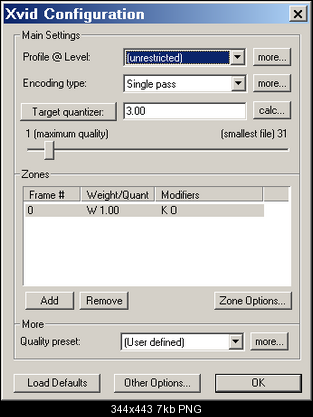

  4. VirtualDub's filter chain is single threaded. So if you're filtering heavily that will become a bottleneck. With Divx and Xvid there's very little quality/size difference between the medium settings and the highest (slowest) settings.
    To use constant quality mode in Xvid set the Encoding Type to Single Pass. If the button below that says Target Bitrate press it to make it say Target Quantizer instead. Set the Quantizer value to the right to 2 or 3. At 2 the resulting video will be nearly indistinguishable from the source but maybe a little larger than you like. At 3 it will show a little macroblocking (you won't really notice at normal playback speed) but it will be smaller. You can set the value anywhere from 1 to 31. You can also use decimal values like 2.5. The smaller the quantizer the higher the quality and the larger the file.
    Divx has similar settings but the terminology and values are a little different.

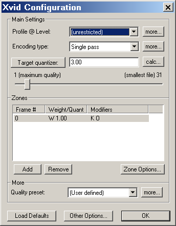

  5. Thank you so much for the quick reply, I do use the setting you have it on the screenshot for quality I Use 3.0 But still the rendering is a bit slow I think specially If i use Smart smooth filter http://neuron2.net/hiq/smoothhiq.html this one It slows down the rendering so much is there a way to speed up things If I do use this filter.
