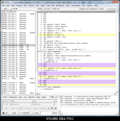

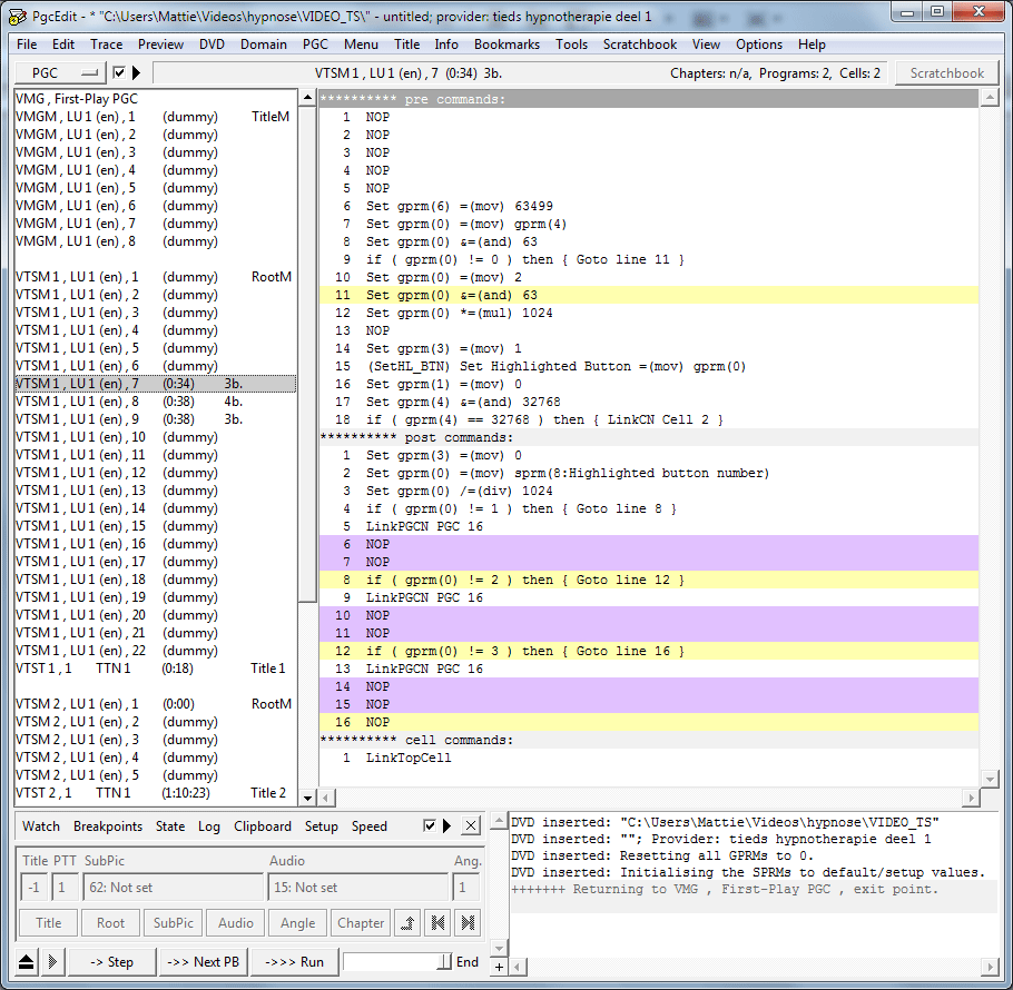

    Anyway, I did as you sugest, but nothing turns up red in trace mode. When I click any VMGM- or VTSM-line on the left, I sometimes get a line with a yellow or purple background in the right column, but that's it (see image):

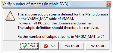

    I do get a warning though when I first load the VIDEO_TS folder, but I have no idea what that info means exactly (see image).

  4. Purple highlights mean that the highlighted lines cannot be executed due to GOTO commands. In your screenshot, they are NOPs (do-nothing operations), so that doesn't matter.
    I guess that the menu currently selected in the screenshot is the first menu. It has 3 buttons, but apparently, all 3 buttons do the same thing: they go to PGC 16. It's strange, as usually, the different buttons should do different things. However, it is possible that PGC 16 jumps to different parts of the DVD, depending of the button that has been activated.

    To fix the wrong button selection by default, just edit the pre-command #10 of the first menu PGC ("VTSM 1, LU 1 (en), 7"). It contains:
    [71 00 00 00 00 02 00 00]  10  Set gprm(0) =(mov) 2
    Simply change the value from 2 to 1:
    [71 00 00 00 00 01 00 00]  10  Set gprm(0) =(mov) 1
