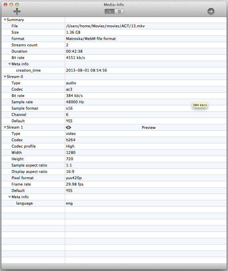

    Sep 2013
    in confusion land
    Hello,
    Bought today a Samsung TV model UA40EH5000M
    I have 4 .mkv files on a usb but the TV will only play 1 of them
    The other 3 only sound is working and instead of the picture it's like random colors ....

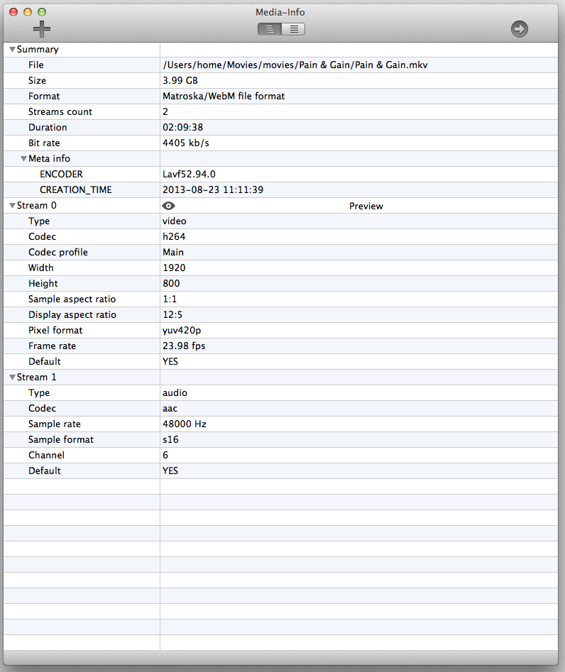

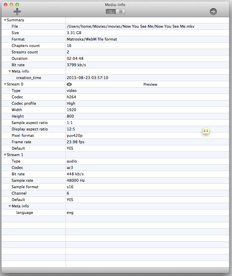

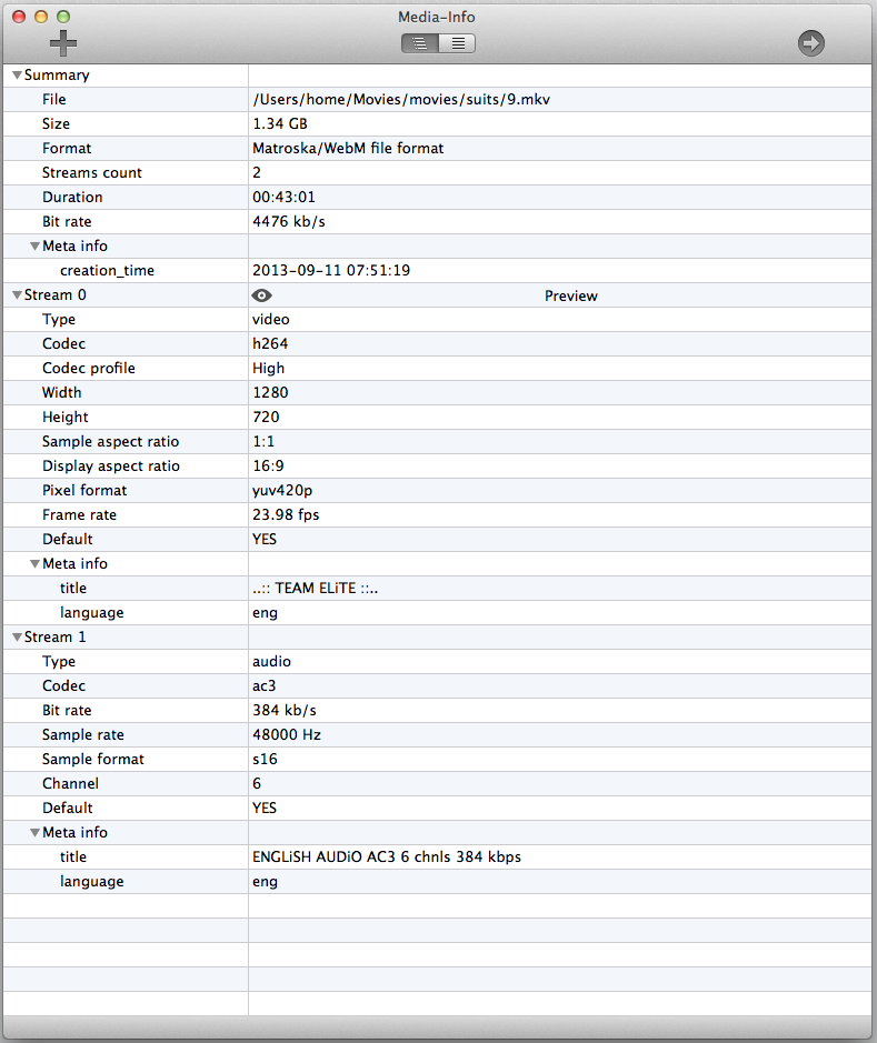

    I will attach 4 pictures of the .mkv files (working and then not-working 1-3)
    Maybe someone can figure out what I need to do in order for it to work
    Many thanks in advance

  12. Banned
    Freedonia
    wwc4d - In general, we'd prefer that you leave old threads alone and just start a new one, but this isn't the worst grave robbing I've seen around here as at least your problem is on topic.
    That's the Mac version of MediaInfo isn't it? There's nothing useful in what you've provided. You'll need to run it under Windows unfortunately and post those results for us to have any chance of finding out what's wrong/different with the files that don't work. Nothing in what you posted above is useful.
    Best guess - the files that don't play have header stripping and the one that plays doesn't, but we can't tell from the Mac version. The Windows version of MediaInfo could confirm that.

    wwc4d: You might try VideoSpec or iMediaHUD instead of the plain MediaInfo. I think they provide better information, but that's just me.
    The OS X version of MediaInfo should theoretically provide the same amount of information as the Windows version, but are you sure you're using the most recent version, and have it in text/tree mode?

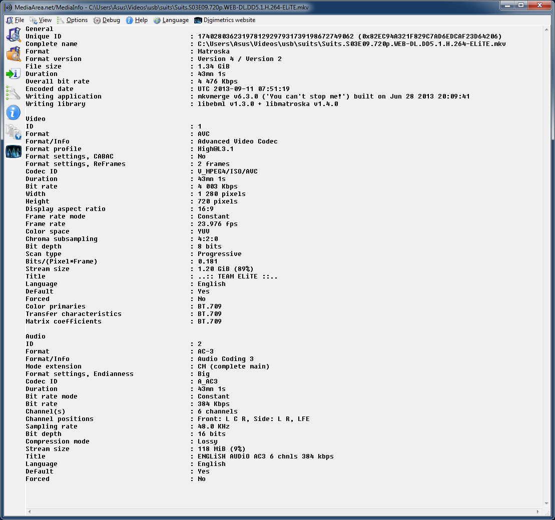

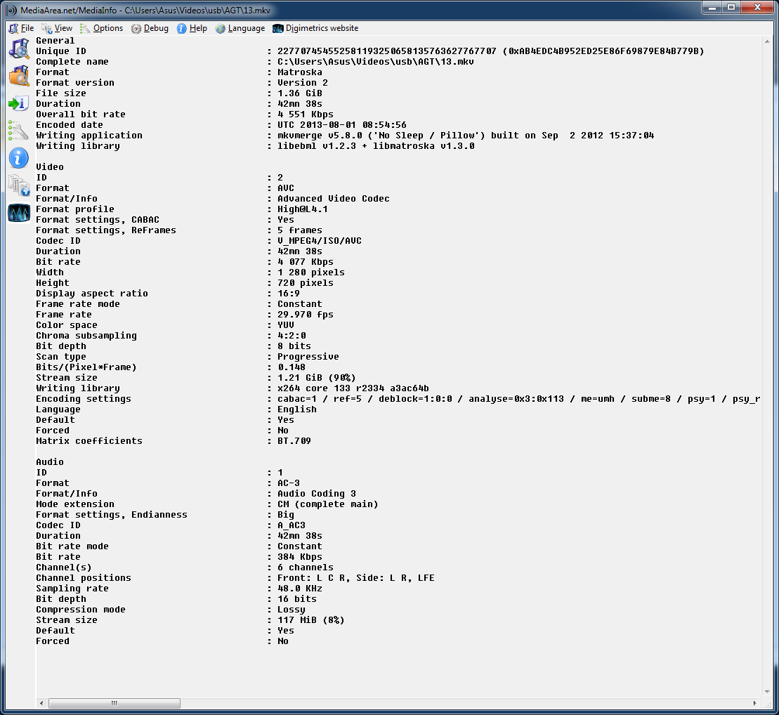

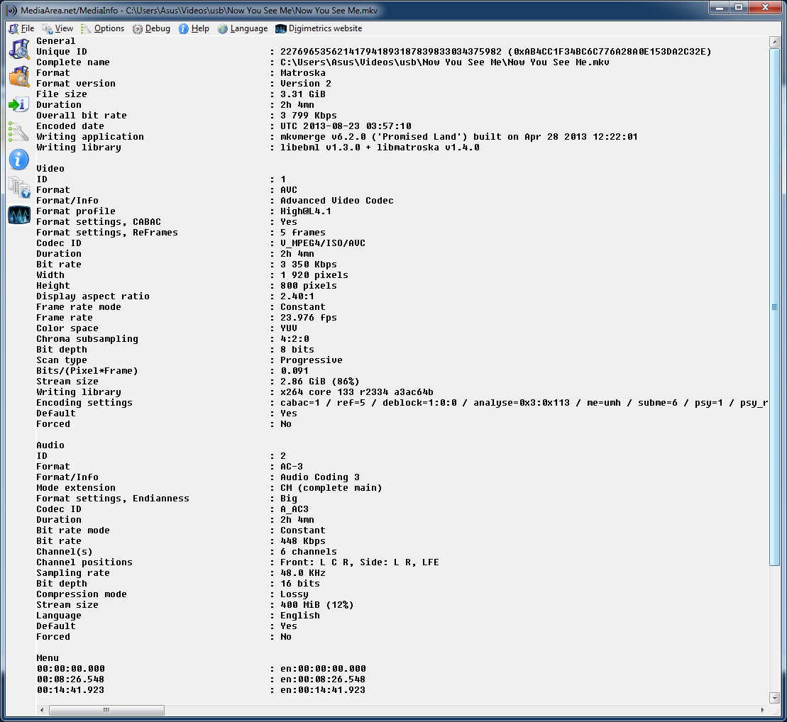

    I tried using MediaInfo on Windows. I hope I did it correctly
    1st picture is the working one, the 2nd and 3rd not working
    Thx again

  15. first has no CABAC and low number of reference frames [marked as ReFrames in mediainfo]

  18. CABAC is ok! Just make sure you do not exceed Level 4.0 limits!
