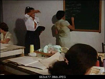

Name:	problem video.JPG
    Here goes a copy of one scene from one of the videos. You can see the video noise in the image. It looks looks like cross hatches.
    Do unto others....with a vengeance!
    Oct 2005
    666th portal
    just looks like bad settings in the encoder. try file/revert all settings and then start over.
