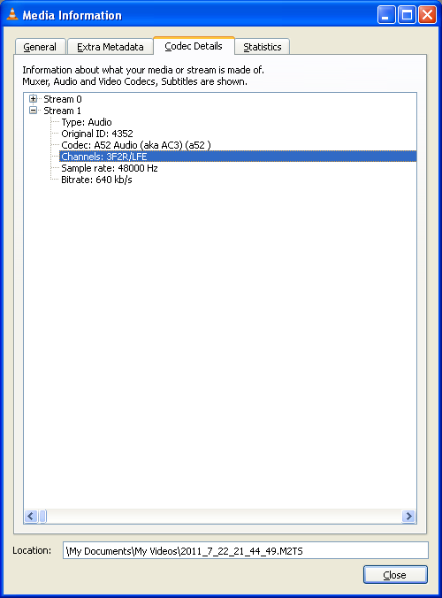

	I've nothing connected to the HD PVR's optical out, but my output.m2ts is still getting AC3 5.1 track, or at least thats what VLC shows me:
 https://forum.videohelp.com/images/imgfiles/sDN5e.png
