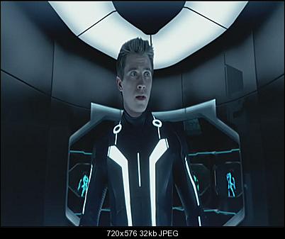

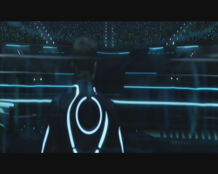

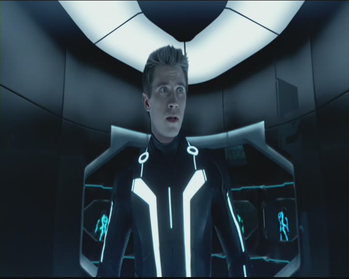

    It is a burned DVD and when inserting in computer, it automatically starts playing, no options. No matter what player (PowerDVD, MPC HC, SMPlayer). It looks exactly this way:
ID:	7847Click image for larger version
    first one (with stripes) is 00:28:30.280, second 00:28:31.280. Both saved from the same VOB using Avidemux.

    It is 16:9 encoded (notice the stretching), with the original footage being 2.35:1 and the Imax inserts being 1.78:1.
    So you can either encode it with AutoGK (simplest) to 1.78:1 and accept that the bars will come and go, or use the hidden settings to over-ride and crop the entire thing down to 2.35:1 and encode without any bars.
    However, any cropping you do in a point and shoot encoder will be a straight crop, without regard for the content. If any of the Imax footage is framed in such a way that heads go above the 2.35 frame, they will be chopped off. This is unavoidable.
    I suspect the original disc has the option to play the straight 2.35:1 original version, which would solve your problem.
