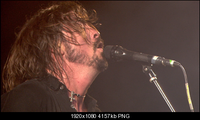

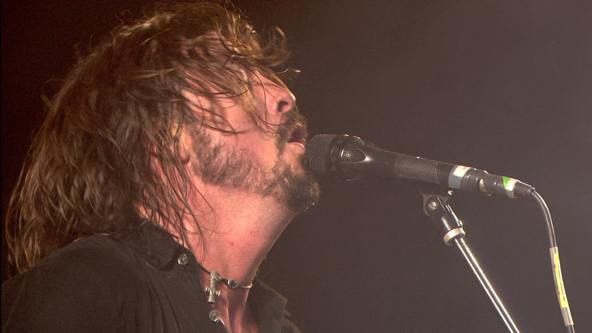

    I've got a video which is a very high quality, Digital HD video source (not film) that has in my opinion a high amount of grain/digital noise. It's visibility varies depending on the shot and it's much more obvious in stills than motion but It's still a bit annoying considering the source itself is very high quality (50Mbps MPEG2 1080i). I'm not sure it would be a factor but it's also 4:2:2 Chroma.
    I'm planning two conversions, one to a H.264 high bitrate Blu-Ray and a standard-def DVD and was wondering if there is anything I could do to reduce the grain on them a bit without losing too much detail due to it.
    Here is a screenshot which shows it probably at it's worst: http://www.megaupload.com/?d=68EKRO9P
    I could provide a video sample if required but at 50Mbps it's going to be very big for even a short part of course.

    Any help? The resoltuion downscale to DVD meant a degrain wasn't really needed there but the blu-ray would obviously stay at 1080i and still be noticable. Anything I can do or is it not worth it? Secondly since I'm re-encoding to a 38Mbps H.264 file for Blu-Ray would it also be worth deinterlacing the file or should I just leave it at 1080i?

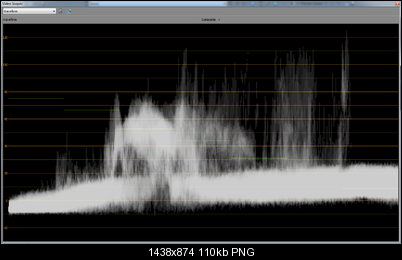

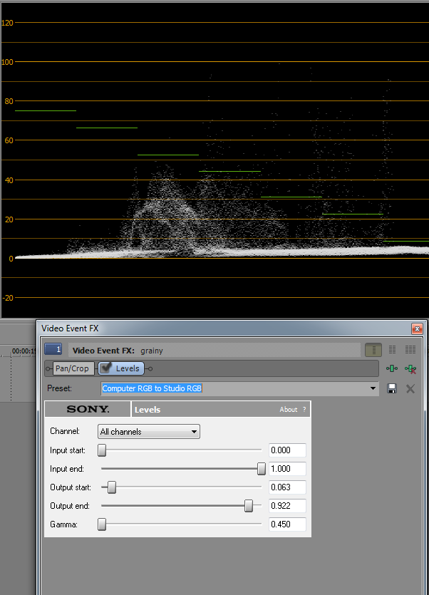

    wrong colorspace maybe?

    Thanks for the response but I don't know what that graph is showing and what you mean by wrong colorspace, and how that would be related to the grain? Mediainfo reports it to be YUV and 4:2:2 chroma.
  6. use a degraining/denoising filter before you encode
    use a motion compensated one to minimize detail loss

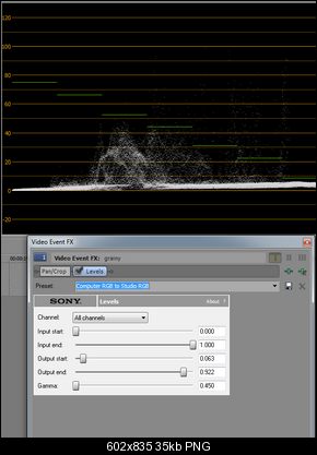

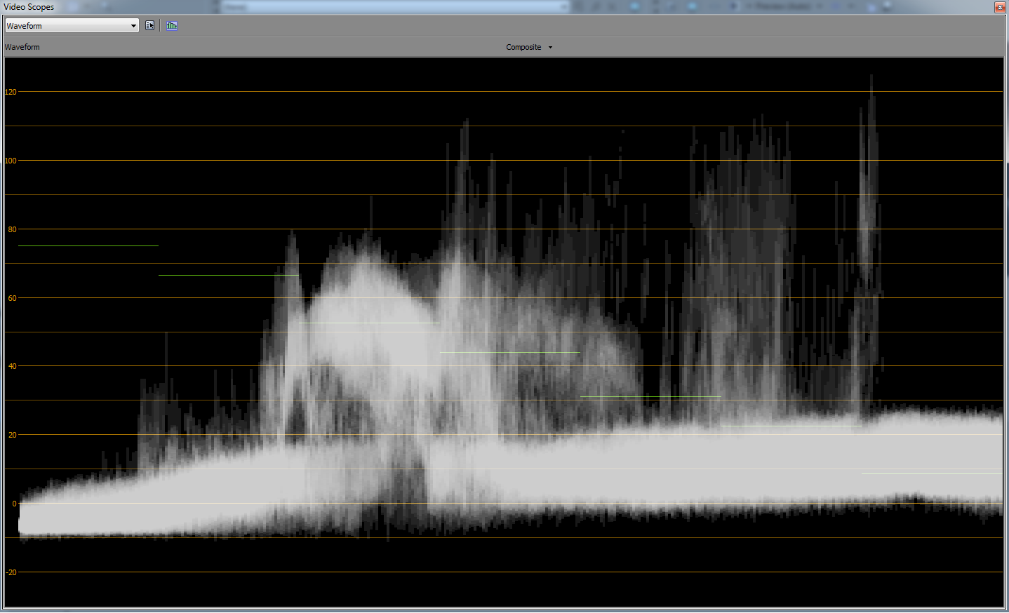

    color level should be in the 0 - 100 range. yours goes below zero and above 100. using Computer RGB to Studio RGB correction i came up with this.
    [Attachment 7933 - Click to enlarge]
    which results in waveform like this with gamma reduction applied to get the black more distributed.

    Ok thanks for the explanation, how would I go about that correction on the video itself though?

    The screenshot was saved directly from DGIndex, which I believe copies it purely?
    This video is a capture of a live satellite stream, captured in it's raw format, so it is what it is. The grain depends more on the shot than the camera, the darker the colors it is the more the grain is noticeable. I also don't believe it's genuinely 50Mbps, but as I say that is how it was captured live so that is what they were streaming it at. I've seen 36Mbps streams which look comparable/better though.
    I've uploaded a very short sample (89MB) here if anyone would be so kind to take a look and see what you think. I've not done anything to it, just cut out and demuxed from the original file with DGIndex.
    Regarding fixing it I know I obviously need to apply some sort of filter and I assume via AVISynth, but which ones?

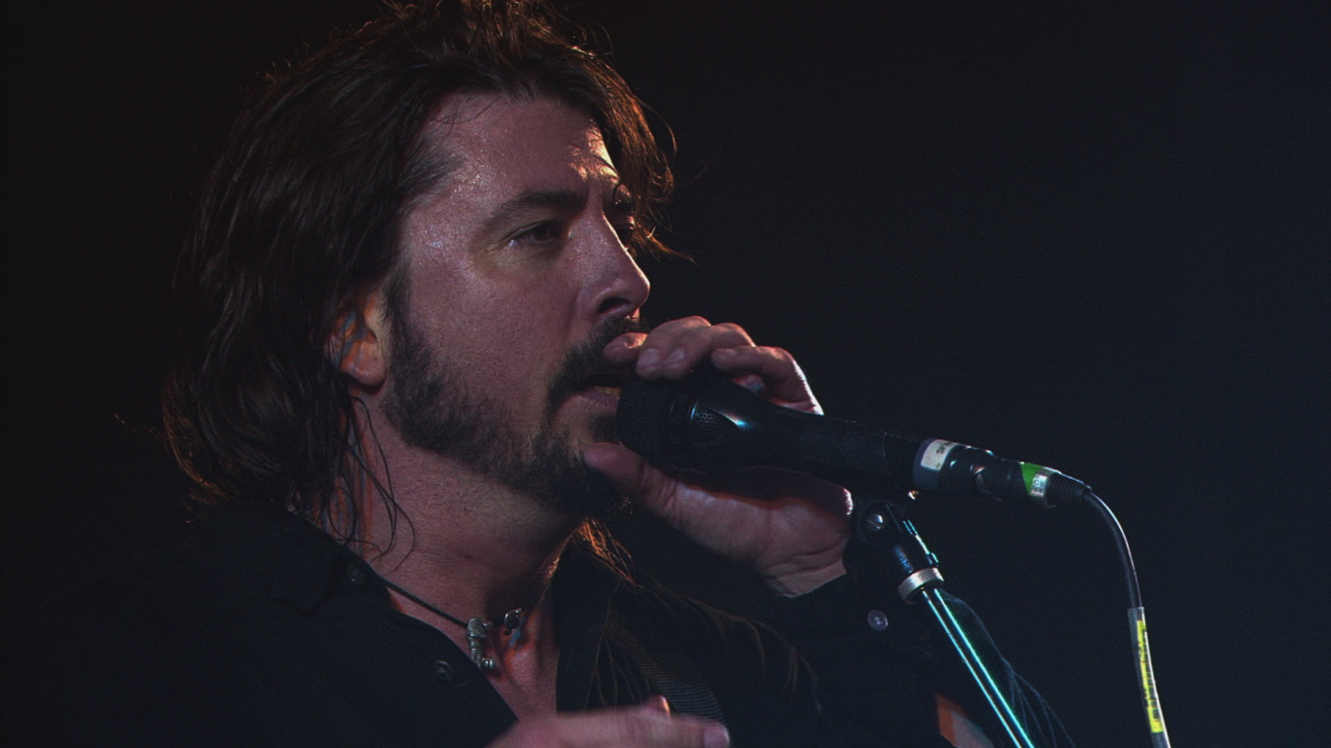

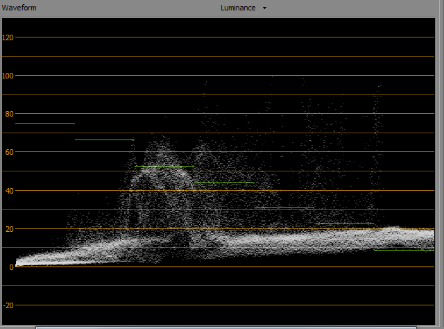

    my god that's some nice video. nothing at all wrong with it. it's whatever you are using to edit with. vegas pro 10 barfed and couldn't handle it, but premiere pro 5.5 does. appears to be from XDCAM HD422 cams.
    here's a screenshot from pp. and i checked all the levels and all appears correct in the video.

    Oh ok, not much point me trying to do anything with it then? I loaded the clip into Premiere Pro just like you and saved a screenshot of that same exact frame and my image looks different. His face is more pink and the background more red hinted than the blacks/greys in yours.
