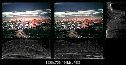

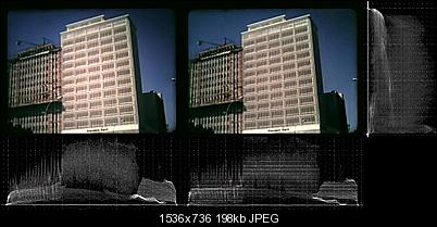

  6. There was some talk about reducing the "hot spot" later in that thread. I took the guys "after" video and the sample all white hot spot frame and used AviSynth's Overlay(mode="multiply") to reduce the hot spotting:

    It probably could have worked better earlier on in the processing. And a little more levels adjustment afterward would have fixed the overly dark areas.
