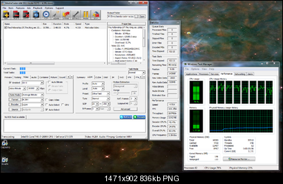

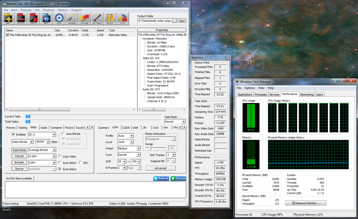

    ok. i'm using a blu-ray rip of lotr fotr extended edition with dts 7.1 es audio for the source. 720p with ac-3 2ch. output. here's what it can do on the slowest "placebo" setting. i'm not going to let it finish as i have no use for it.

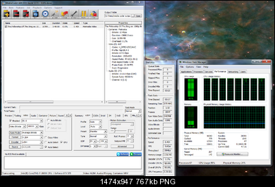

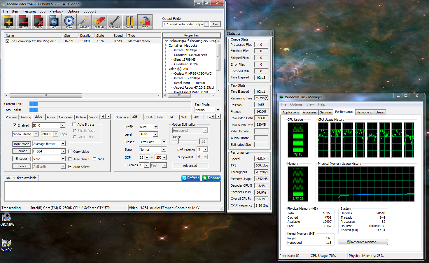

    here's ultra-fast preset.

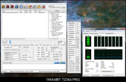

    medium(there is no normal)

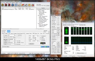

    cuda
  8. aBigMeanie aedipuss's Avatar
    Oct 2005
    666th portal
    some readings seem weird. throughput of up to 287MB/s? what's it doing adding read + write together? my samsung f3's can do about 140MB/s sustained. ultrafast and cuda do seem to be limited by the drive transfer speeds, unused cpu clocks left over.
