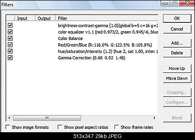

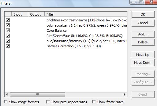

    The stuff that I have been working on are not VHS recordings. Old Film transferred to Digital. On these specific films, the red levels are way to high. From knowing what the grass and tone of people's faces are supposed to look like is how I adjust the color. It is not easy tweaking color cause one thing effects another. This is an example of the specs used on an old film from 1964. On this film decided to make special frame adjustments pulling out and re-painting many of the(frame damage with random spots). All the video edits or frame restoration are done before any color tweaking.
    Thanks for the heads up on picture adjustment, set all my own calibrations on most of the media stuff I have. With the Laptops, never really needed to tweak the overall color.
    I use several filters myself, but I note in the image that you used 2 gamma filters and 4 different RGB filters. If you're not using a histogram control (can be turned on and off to check what you're doing) and not using a tool for measuring pixel values, color adjustment becomes quite difficult. Many RGB filters work differently; the ones you're using have no means of controlling each color for dark, midtone, or bright values. That, too, makes it tougher. Judging color and calibration by eyeball alone is really tough, if not impossible.
    ColorMill has 3-stage RGB, gamma, level, and other controls for darks, mids, and brights. A properly designed RGB filter should affect only one color at a time; if you adjust Blue, it should have no effect on Red and Green. Most people start color correction by first adjusting brightness and contrast. These two elements strongly affect the way the eye perceives color and saturation levels. So does wallpaper or a colored desktop; set your desktop to a plain gray, around RGB 32 to 64.
    It sometimes helps to view a grayscale-only version of the image (use VDub's grayscale filter) to initially adjust brightness and contrast. This does require that you jockey back and forth a few times between grayscale and color views, since many color adjustments affect brightness levels, and vice versa. Normally the only RGB controls I use are ColorMill and the gradation curves. Too many color filters can get in the way sometimes, though I've often loaded the brightness-contrast and HSI filters as you show.
    After setting basic contrast and brightness, the easiest way to start working on colors is to note how blacks, grays, and whites are displayed, followed by skin tones. If you get those looking right (assuming you're not dealing with a strongly colored light source such as orange floodlights or blue neon), most other hues will start falling in place. Rather than start by correcting green grass, if there are clouds in the image you might try getting clouds to look white to begin with (the shadows of clouds are usually gray, with very little blue). Direct-lighted grass is just above the illumination level of midtones, or about the same level as 65% gray. Under normal lighting, skin midtones rarely go above RGB 160 to 180 Red, and bright skin highlights look a bit odd when higher than RGB 220 -- but much depends on lighting conditions, etc., and whether you're correcting male or female skin. And even then, there are wide variations in real life.

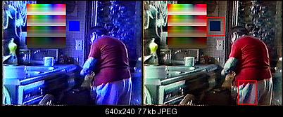

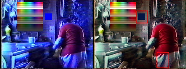

    I overlayed some reference colours on the source image to see how they'd get transformed:
    Saturated blues are, of course, greatly reduced. I decided to let a bit of blue through (as can be seen on the folds of the clothes) - but it's a compromise. Hopefully, the areas that are slightly blue (but shouldn't be) aren't too objectionable, and the areas that should be blue are just blue enough. But it's very difficult to balance.
    Initially, I thought there might be a way to distinguish between the areas where the blue should/shoudn't be and filter accordingly. But, from looking at the channels, I don't think that's possible.

    I'm not ready for public display yet, maybe tomorrow. Is there anything I can do to enhance that AVISYNTH script?
  24. OK, I've moved on for now. I became a mad scientest with secondary color correctors. Then I remembered that I am using an uncallibrated monitor so I eased up on some of my tweaking. This particular footage is in very bad condition, I got to a "good enough" point then moved on to new clips.
    I didn't realize how good I got with the secondary color correctors until I worked on some less degrated footage. It appears that I am now able to correct a wide range of color problems on my VHS footage. That secondary color correctors in VMS is the icing on the cake for my VHS restorations. Chaining 3 or 4 of them together, I can eliminate obnoxious color haze, purple hot spots, and over exposed yellow glare until my hearts content.
    Though I'm still not sure where the best place is to put my deinterlace on my script. It seem that most people place it at the top. Running removedirt on the individual fields seems to make an improvement over running it on progressive frames.
    Only about 200 more hours of processing left, then I get to move on to the VHS-C footage.
  25. Imo you should put whatever deinterlace filter at the end of your script because for instance QTGMC slightly change the levels, that's what the histogram tells me in avisynth at least.
    Can you put a sample of your restored video i'd be curious to see the end result thanks.
  26. Looks something like this. Far from perfect, but way better than it was.
