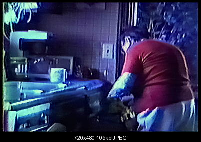

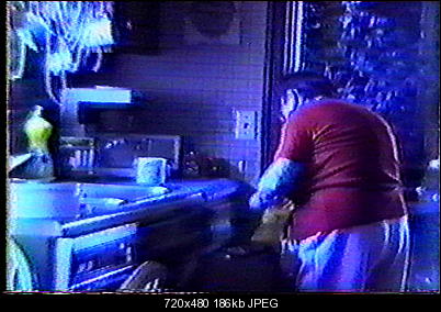

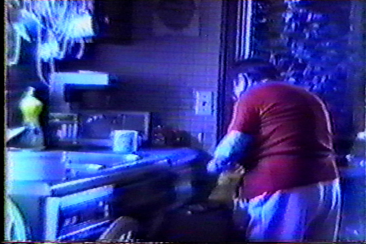

  8. Here are some stills of my before and after so far. This is a frame from some of the worst of it.
Name:	raw frame.jpg
    I'm using a chain of filters in AVISynth and VDUB Seperate feilds>remove dirt>weave>QTGMC>color EQ>camcorder color denoise>docrawl comb filter>neat video>fill boarders
    Maybe over processed, but the footage is horrible. The color situation has a bad blue cast. I fixed it a bit just dialing back the blue in the color EQ.

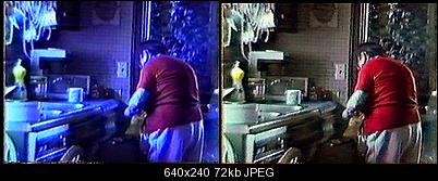

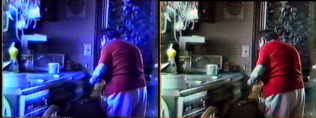

    Here's my attempt at restoring the video:
    I had to guess at what the colours should be; the kitchen looks 70s/80s, so I guessed that the door frame and underside of the coffee maker were brown.
    I used Blender's node system for colour correction, but the process could be recreated with AviSynth. Also, Blender's nodes can be rather slow, which can be a pain when working with long videos.
    All I've done is reduce the blue channel - if there aren't any objects in the scene that are blue, you'd probably get away with this technique.
    I have another idea up my sleeve for getting rid of the blue tint, but simultaneously keeping anything that's obviously blue - but it's somewhat more complex.
    I should add that I initially tried to correct the colour with standard RGB curves, but realised this wouldn't be effective, so switched to working in YCbCr mode - only using RGB curves for a final minor tweak to the image.
    Anyways, let me know if you're interested in this technique and I'll post the details.

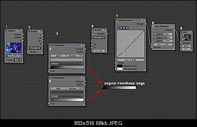

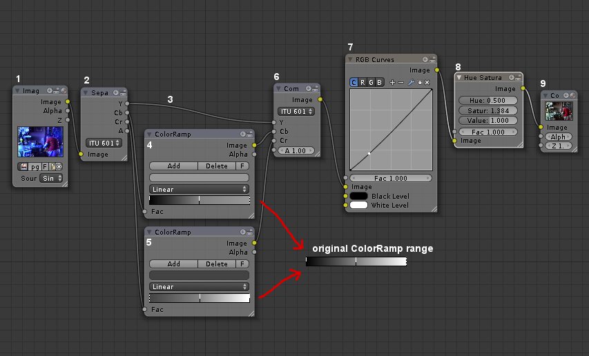

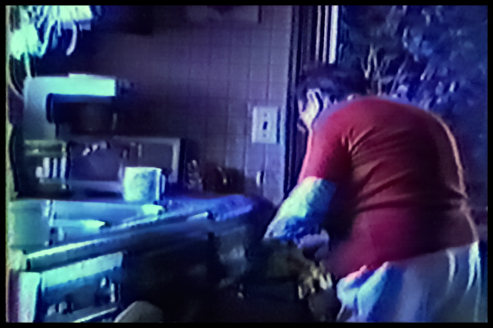

    Here's a screenshot of the nodes:
    This is the procedure:
    1. source image (or video) is on the left.
    2. separated to YCbCr
    3. Y passes through unaffected
    4. Cb has values remapped
    5. Cr has values remapped
    6. recombined
    7. minor colour correction with RGB curves
    8. saturation boost
    9. output
    To better explain step 4 (Cb); the source has a range of 16-240, but the 'ColorRamp' changes this:
    - Values 16-128 are unaffected, but values above 128 are distorted - only reaching 151 (instead of 240)
    Step 5 is similar although only the lower half of the range is affected - 16-128 is remapped to 69-128.

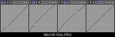

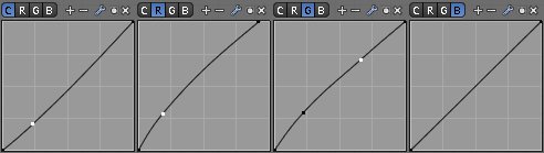

    Here's the RGB Curves settings:
