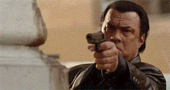

  1. When I make an animated gif I'm able to open it later and resave it at the same file size. Sometimes I'll find a gif where this does not apply. Two examples:
    https://forum.videohelp.com/images/imgfiles/s5ZW5.gif
    and
    https://forum.videohelp.com/images/imgfiles/mn0lG.gif
    With those two, it's impossible to resave them at the same file size using ImageReady, Jasc, or Premiere. The file sizes bloat by 1M.
    Any ideas about how these gifs were super-compressed? I thought .gif was a lossless format that allows you to clone an image. If there's a better forum to post this lemme know and I'll move the thread. Thanks!
    IIRC, at least Microsoft GIF Animator had a "P-frame based" compression mode --- i.e., certain frames were compressed as the "difference" between themselves and the previous frame.

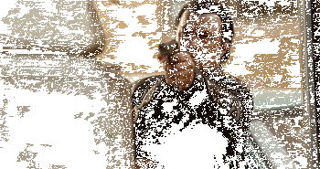

    Yep, the animation in the second link has a tansparency applied to every frame.
