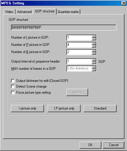

Those command line arguements should give you the correct GOP structure from ffMPEG. However if you would rather use TMPEGEnc for this, simply click on the "setting" button and enter your required settings under the video tab. After this, go to the GOP structure tab and matching your settings to this screenshot should give you the GOP structure you require.
[Attachment 7775 - Click to enlarge] -

Looks like its back to the old fashioned way then.
Under the GOP structure tab:
Number of I picture in GOP: 1
Number of P picture in GOP: 4
Number of B picture in GOP: 2
Output Interval of sequence header: 1 GOP
MAX number of frames in a GOP: 15
The tick boxes at the bottom specify other modifications to the GOP. Not knowing what you intend to use the outputted video for, I can not recommend settings for these. However if you are having trouble, I would recommend leaving them all off.
