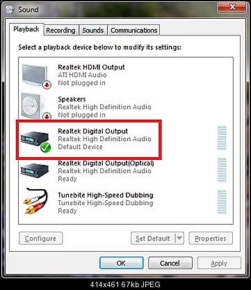

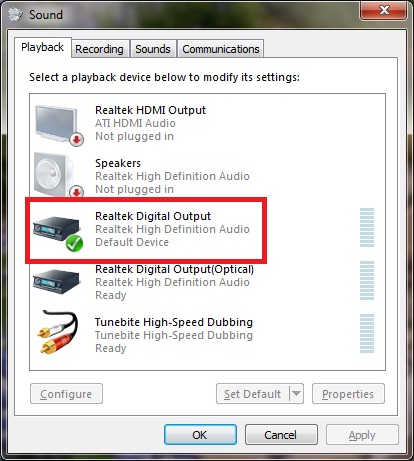

    Those settings should be in your audio or 'Sounds' setup for your motherboard. (Look in 'Control Panel'.) I have a couple of PCs that defaulted to HDMI audio and I just set up my PC to direct all audio out to S/PDIF to my surround sound amplifier. I use a DVI>HDMI adapter for my projector and there is no audio there with that adapter.
    But most times, you just need to redirect the audio output to where you want. That would not be in the Nvidia settings, but instead in your audio card settings.

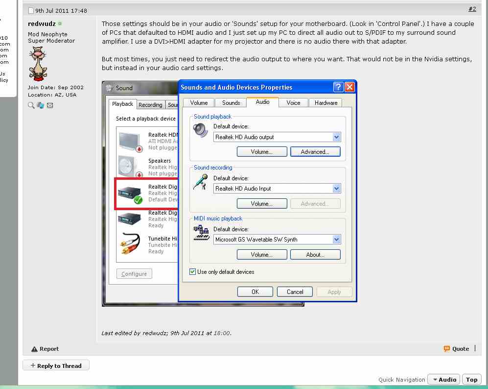

    Thanks for your help. In Windows XP, I don't seem to have those options, at least in control panel/sounds and audio devices. The only option is each drop-down arrow is Realtek HD Audio
    Here's what I see:

    AFA disconnecting the audio output, but not the video from HDMI, IIRC in Win XP you would go to Device Mgr and Disable (NOT uninstall) the listing for HDMI - in the Audio/Soundcard section only. It's not just a matter of making another device the default, you have to not have HDMI as an alternative, as it expects to be the default when the HDMI (video) is plugged in and tries to force the issue.
