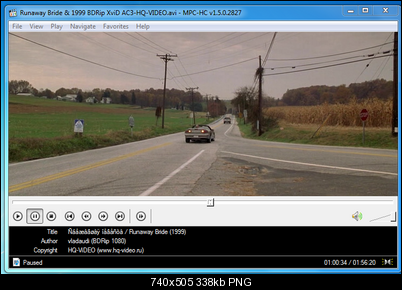

    Hello friends, as you can see in the picture how can I add metadata?

  2. abcAVI Tag Editor you can find it here on VideoHelp.Or link to author's site .

    Thanks. I try but ;
    File *****.avi has very large size (more then 2Gb) and has been skipped
  4. Well this tool is quite old you can expect thing like that. Maybe someone knows alternative.
    Sorry never cared too much about tagging - even my music is not properly tagged .
