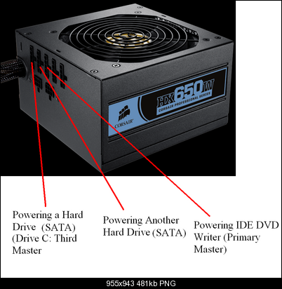

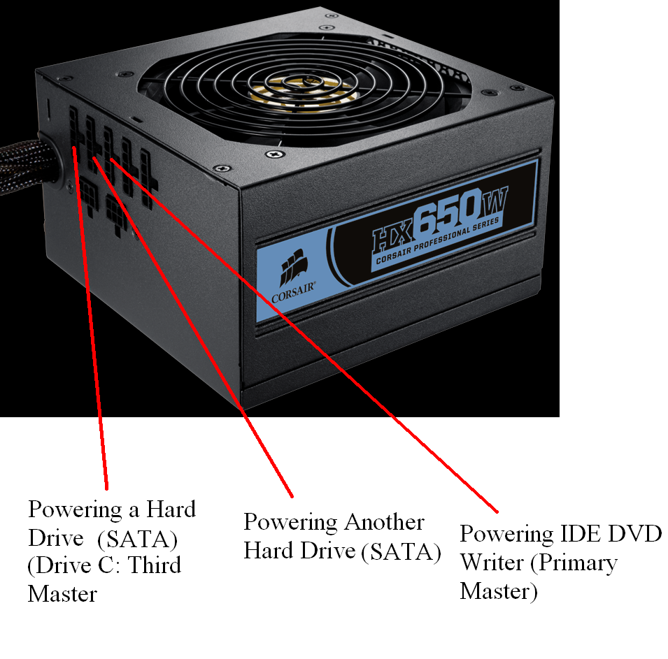

  10. Member SE14man's Avatar
    Jul 2005
    Queensland
    Hey guys,
    Well i have just bought the HX650 PSU. It has a few sockets on it for SATA & IDE cables.
    I have made a picture below and was wondering if i have got the setup correct.
    Basically i have one SATA cable in one socket powering 1 SATA HDD (Drive C , then another SATA cable in the socket next to that powering another SATA HDD (Data Drive F then another cable plugged in next to that which is powering IDE for the DVD Writer.
    When i look in the BIOS the DVD Writer is at the top of the list being the Primary Master, is this ok?
    Then the main Drive (C is also a master but is third master. Is this ok to have this setting or should i change things around?
    Please also look at the image to tell me if i have done everything ok.
    Thank you.
  11. It doesn't matter which connector the drives are powered by. It also doesn't matter what order the drives appear in the BIOS since you can change the boot order. Although I like to have them in order to make it easier to know which drive is which.
