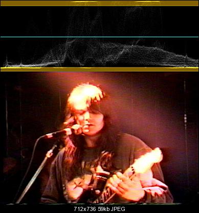

    i messed one capture with virtualdub i did a 576 height instead of 480 (712X576)
    so i cropped the 96 lines with virtualdubmod (704X480)(not supposed to mess the colorspace)
    the cropped sample is 3 samples into one is it still workable or should i recapture ?
    what would you suggest with this one ?, colorwise : lots of reds
    vhs tape taken from a camera unknown type
  2. VirtualDubMod converts to RGB with the 601 matrix when you crop. Given that capture1.avi has a lot of video below Y=16 and above Y=235 you are going to lose those details by cropping in VirtualDub(Mod). The other clip looks like it has already been clamped.

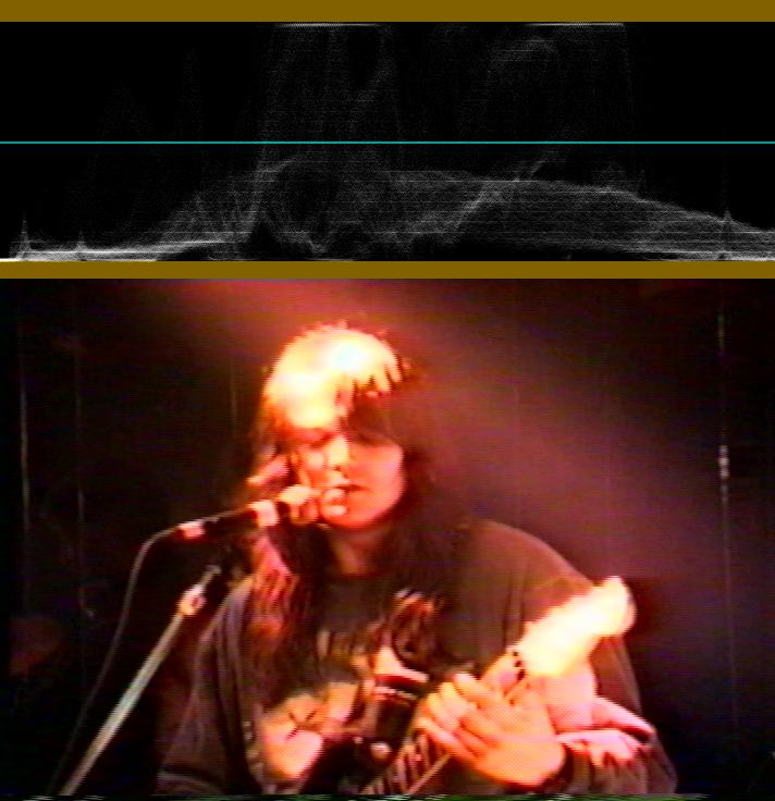

    original:

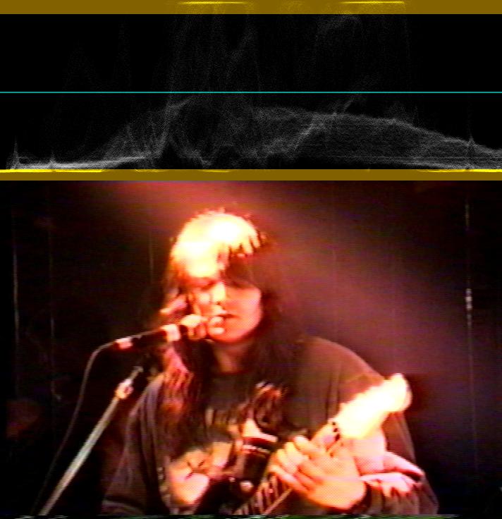

    after ColorYUV(cont_y=-25, off_y=-7)
    With all the colored stage lighting it's hard to say what color corrections sample3in1.avi might need. Judging by the second shot this looks like a good starting point:
    ColorYUV(cont_u=-20, cont_v=-50, off_u=6, off_v=-8)
