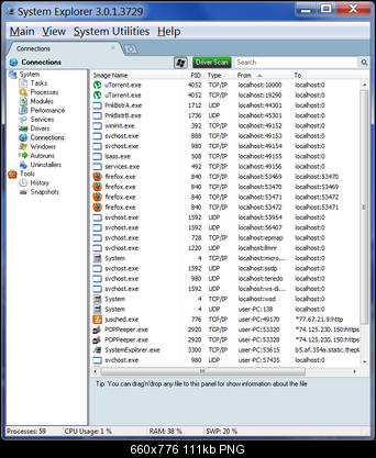

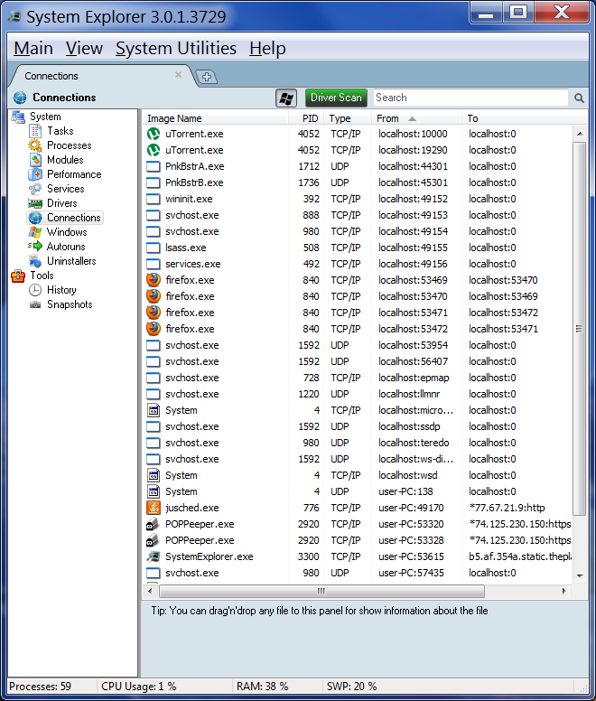

  4. Freeware System explorer can see what process using internet in Connections section
    Go also to History to see what loaded on startup
    [Attachment 7683 - Click to enlarge]
    I dont seem to have a connections tab
    I clicked start as admin but still didn't
    Oct 2005
    666th portal
    click the box at the bottom of task managar - "show processes from all users"
  8. Originally Posted by Tbag View Post
    Try select from above View -> Show Left Menu
    or try exit by Main -> Exit Application and start by right click on System explorer shortcut and select Run as administrator

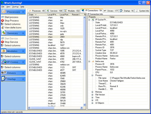

    use a free app called "Whatsrunning"...has everything you''ll ever need to see what's runnin in the background...been usin it for years
    Whatsrunning

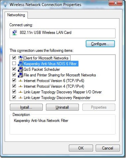

  15. Did you try disconnect/disable wireless, restart and run speedtest only from LAN?
    In safe mode Antivirus is off, try disable kaspersky filter in LAN and wireless connections, restart and run speedtest again only from LAN with wireless disabled.
    enable kaspersky filter after test
