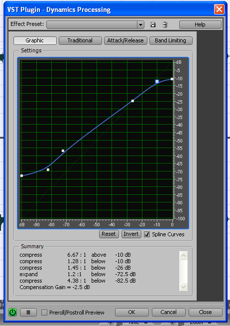

    You've got clipping, so you need to start by doing clip restoration. Did that, lowered by ~4db.
    Then, I added dynamics processing, kind of like what you were talking about, but I set the gain so:
    * Note that I set the attack & release times to be very short (1ms A, 50ms R, maybe shorter on the level sensing) and linked the 2 channels.
    Then, I added a mild bass boost for oomph on the bursts and a little improvement for the vocals (parametric EQ - beefy snare preset to start)
    Then, I did a normalize to -0.333dB.
    Is this what you're looking for?

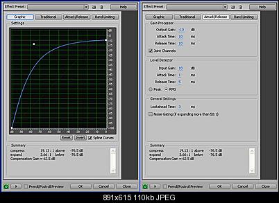

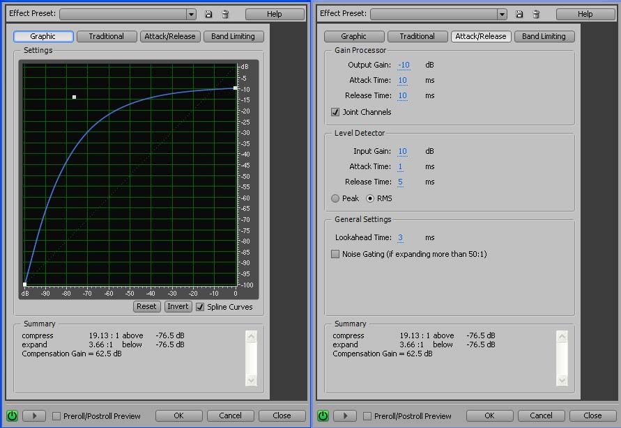

    I'll give an example of the kind of sound I'm after. This was achieved with the following graph and settings (after a -4dB clip restoration which I forgot to mention I'd been doing):
    The resulting audio is very heavily clipped (fair warning!) but it is pretty close to the sound you'd get from a camcorder recording the same events.
