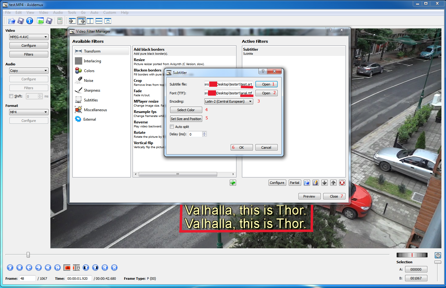

    Ok, i tried using avidemux with "subtitler", and it works
    So, in subtitler you should choose which font you want to use, if you dont choose.. there will be no subtitle in the output.
    Just go to windows/fonts and copy "arial" or "tahoma" or whichever you want, and paste it on desktop or in the video file folder, and use it with subtitler.

    EDIT:
    Okay, I just got the chance to try your suggestion. For once, I could actually go on with the process!! THANK YOU............
    But, other issues appeared:
    1. The audio and video are not in sync! It seems like it got worse toward the end.
    2. The subtitle did not successfully embedded into the end result.
    (here is the link to the screenshot of the subtitle setting:
    http://www.mediafire.com/imgbnc.php/146fb636d1e0992327e7716b2cdd9f79eb0707f78e3fafe4cb...be20681b6g.jpg
    as you can see, I chose "filter -- subtitles -- subtitler" because my subtitle is in .srt format)
    3. Seems like the quality of the video toward the end is very bad, similar to VERY LOW bitrate.. but, the video looks good in the beginning! So I don't know what went wrong.
