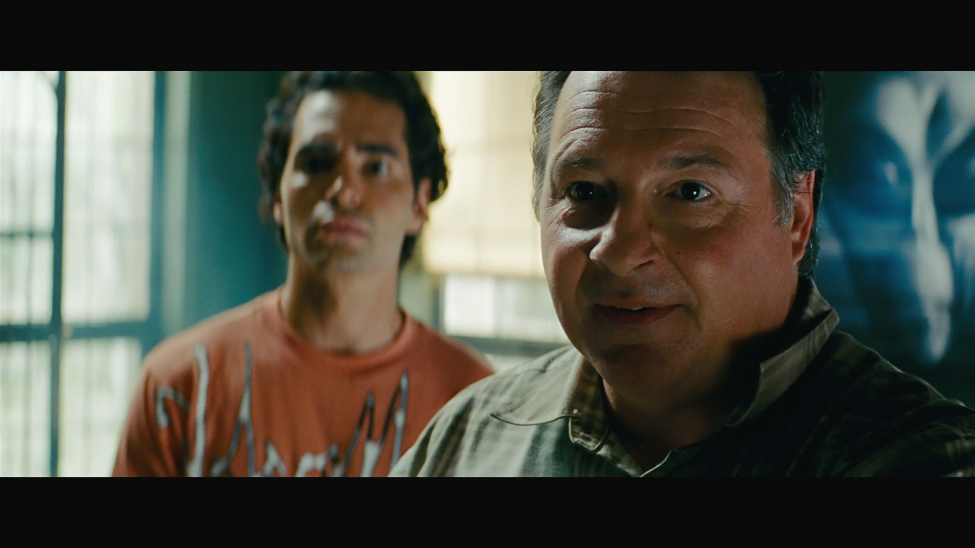

  5. Thank you for correcting my flawed and noob logic. You are right, the two test videos are different. I never tinkered with the color settings in Nvidia control panel (GTX 460). Now I have it forcing full range (0-255) across all applications and both the test videos are identical. Does this color setting affect Youtube videos I upload and watch? So the reason the two videos are different is because RGB videos don't require conversion and is played exactly as is intended, but with encoded videos, which are mostly YUV, they undergo conversion through the video player settings or video card settings, which in my case was limited range (16-235)?
    Now when I play some of my mkv x264 movies/animes, they also seem darker, but to a point where dark areas that I can normally see details are completely black. When I watch videos now, how do I know I am watching them as the author/creator originally intended? Is what I am seeing suppose to be this dark? The top frame is limited dynamic range (16-235) and the bottom frame is full dynamic (0-255). See how the left shoulder area of the father is completely dark and loss the detail of his flannel shirt?
    I just want to make sure what I watch is what was intended by the artist/director/animator etc.
    The darker video is a little too dark. As you noticed, all the details in the darkest areas are gone. You need to fine tune the brightness and contrast controls in the video proc amp settings. In the test video the bars labeled 10 and above should be visible. The 5 an 2 bars will usually be very difficult to differentiate from the background. If you view the monitor from an extreme angle they may become more visible. At the top end you can usually see all the bars. The highest bar, 253, may be a little hard to see.
    What I usually do is adjust the monitor's controls using the RGB chart. First set the Desktop brightness, contrast, gamma, etc. settings to neutral. Then play the RGB video and adjust the monitor's controls. Try to get the blacks as black as they can get -- while still being able to see most of the darkest bars. The brightest parts should be at a comfortable brightness (they don't have to be as bright as your monitor can get) and all the bars should be visible. Then use the YUV video to adjust the video proc amp settings to match the RGB video as closely as possible.
