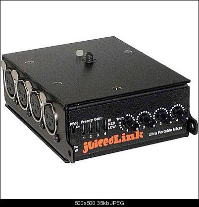

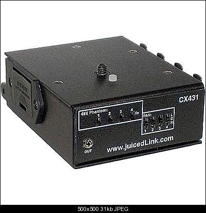

    Hi everyone - I'm trying to take a baby step into a bigger world and up the quality of the sound accompanying my videos. I am shooting what I hope will become a successful podcast with 2 hosts in an indoor setting. I plan to mic them both with wireless lav mics, which I've purchased (Azden WLT-PRO) and also use a shotgun mic on my camera. I only purchased one receiver for the lav mics and I also bought this 4-channel mixer - JuicedLink CX431.
