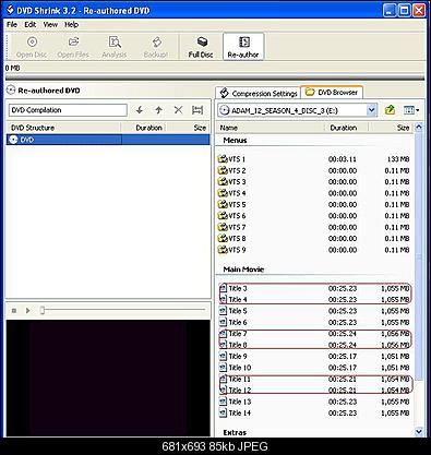

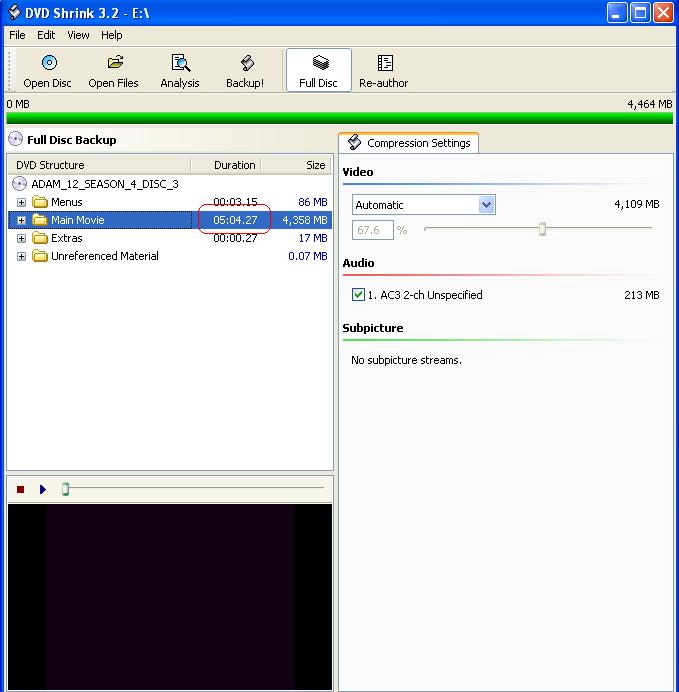

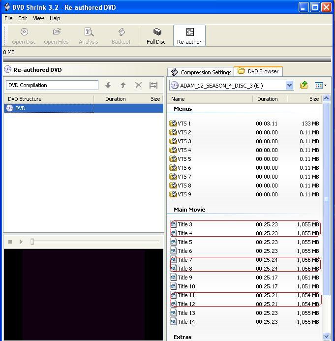

    Here's a more detailed example with pictures:
    I have an episodic TV show on dvd disc. There are six 25 min. episodes on the disc so the running time is 2hrs 30 min. When I open it in DVD Shrink full disc mode, it says the running time is 5 hours! In re-author mode, there are 12 titles instead of 6. The titles are doubled, each twin has the same 25 min. running time and size.

    it can also be caused by simple seamless branching. like some old star wars dvds. the intro was in 2 languages and it was branched, causing all ripping software to think it was twice as big as it really was.
  7. Banned
    Freedonia
    It could also be due to the person who authored it being incompetent. Some TV show DVDs are some of the most strangely authored DVDs ever made. But I wouldn't discount the possibility that was it done deliberately this way to mess with shrinking programs and make them compress too much, resulting in bad quality.
  8. Thanks for the additional information.
    What happens when you do a backup, with compression, to a disc? Specifically, what does DVDFab (or DVDFab HD Decrypter) produce as far as files ready for burning?
    Usable? Too compressed? What?
    You may find that DVDFab knows what to do with those "twins" and give you what you want/need.
    Remember, DVD Shrink, although still very useful at times, hasn't been updated in years and nowadays may not know how to interpret these newer schemes. However, DVDFab/HD Decrypter may know and give you what you need to input into DVD Shrink.

  9. Looks like an incorrect decrypt to me. How'd you get this one onto the hard drive? If DVDFab HD Decrypter, try running it through FixVTS afterwards. If Shrink, go back and start all over again.

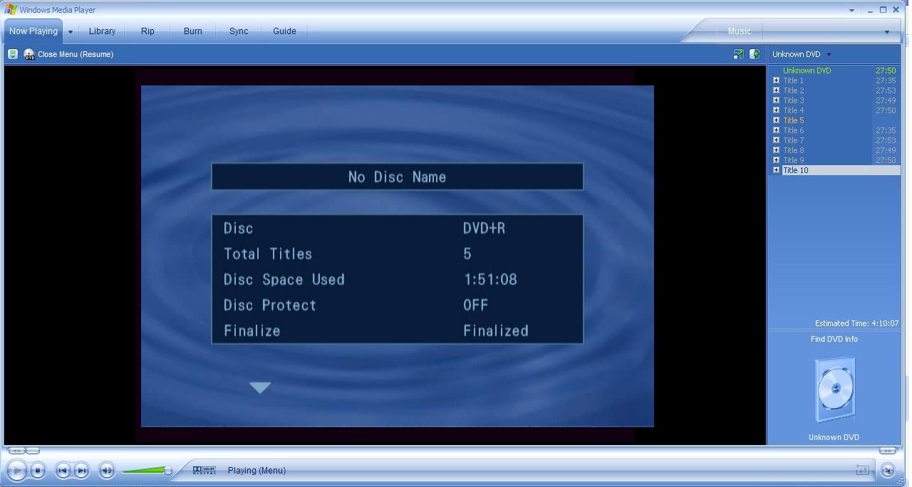

    I'm still having this problem 3 years later. This is really frustrating me.
    It's not just DVD shrink. I'm also playing a dvd on Windows Media Player.
    The disc has 5 titles, but in the info box, it says there are 10 titles, so it has doubled!
    I personally recorded the disc. There are only 5 titles.
    There are 4 episodic TV shows under 30 minutes each (in SP mode) and one blank title. The total running time is 1 hour 51 minutes, but as you can see in the info box to the right, it says 4 hours 10 min.
    This happens on every disc I play: retail or self-made disc.
    This makes it very difficult to dupe a disc on dvd shrink or decryptor because the output size is always doubled.

  12. Ronnie G:The disc has 5 titles, but in the info box, it says there are 10 titles, so it has doubled!
    Maybe not? The SOFTWARE says it has doubled. Don't overlook the possibility the SOFTWARE is giving you erroneous readings.
    If you burned your own disc to a SL disc, with the max capacity being ~4.7 gb, and the SOFTWARE says it's twice that (which is impossible), 'tis the software giving you a bogus reading.
    I sometimes record TV shows to DVD-RW, which gives me a DVD-VR disc, and then convert to a standard disc in DVDShrink via Re-Author. DVD Shrink always shows what I recorded as two separate recordings, same size, same length (far in excess of the capacity of the disc). Yet, I know that's not true. I just drag-and-drop one of the two and make my DVD.
