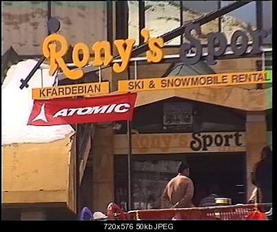

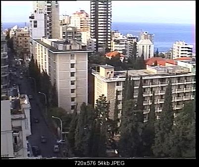

    My first question refers to the quality of the images. From the photo below, there are a few things I am having trouble with.
    Firstly, I am assuming that the artefact at the bottom of the picture is due to overscan so I have so far ignored that. I presume that the green/ pink lines on the right and top borders of the picture are due to dirty video heads (if that is the right word) on the camera. I have used a cleaning tape with no benefit. Buying a new camera, let alone a Hi8 deck would be quite expensive, and I could potentially live with these lines. Moreover, I have read that the best quality to be gained (within reason) was from playing the tapes on the camera they were recorded on, and that DV8 cameras that can play Hi8 cameras aren’t as good as the original camera which was designed to record and play only in Hi8).
    Secondly, the camera has a timebase corrector enabled. I understand that this is likely to be a ‘line’ TBC and not a full frame TBC and therefore not provide much benefit. However from all the examples I can find online, the amount of tearing in the picture from the VHS tapes used is quite significant and not quite what I am experiencing here. For all intents and purposes, attempting to ignore the fact that I am watching the video on a 1900x1200 monitor (deinterlacing using VLC makes no difference) makes me believe that I have a reasonably good quality copy of the Hi8 tape. So I suppose the question has to be whether getting a TBC (my eyes on the AVT-8710) would correct the ‘jagginess’ of the video, or whether the picture I have now is essentially as good as it is going to get.
    I appreciate that some of this may be repetition but all the answers I find relate either to VHS specifically, or hardware that is more than five years old. I suppose therefore my main questions are whether it is worth buying a) a new camera and b) a timebase corrector.

  2. Member Cornucopia's Avatar
    Well, I'm one of those that feel that DV is more than capable of fully capping Hi8's quality (even using the best of cameras, which yours isn't), so I think all the other stuff is overkill. The only thing missing in the DV spec compared to Hi8 is the reduced colorspace, though if you're going to be ending up with MPEG2, and you aren't doing compositing, you won't notice or miss it anyway.
    AFA TBC is concerned, you need to zoom in on your image and verify whether that jagginess is just standard interlacing or not. If it's just alternating lines, it's likely normal interlacing with maybe the field order being wrong; if the jaggies have more than 1 line thickness, you've got other problems and probably will need a TBC (good to have anyway).
  3. Formerly 'vaporeon800' Brad's Avatar
    Apr 2001
    Vancouver, Canada
    Are the shots from the MPEGs instead of the AVI captures? I'm seeing significant blocking.
    I see significant "DV checkerboard" pattern (moire).
    VLC deinterlacers are not perfect. You'd have to watch on TV for true test.
    DV introduces extra layer of colorspace compression.
    Generally speaking, multiple colorspace changes are not a good thing.

  5. Member edDV's Avatar
    Mar 2004
    Northern California, USA
    Originally Posted by m_00 View Post
    The intensity pro did come with the software ‘Blackmagic media express’, which supports MJPEG capture or 10bit uncompressed AVI. I think choosing uncompressed AVI option may be too much data for my system to handle, as recording in this results in the video lagging, then speeding up, then lagging again.
    Issues:
    DV - reasonable quality at 13GB/hr (fast editing)
    10 bit uncompressed - on order of 130 GB/hr ... needs RAID
    BM MJPEG - 75 GB/hr (fast editing)
    Huffyuv ~ 40-60 GB/hr (laggy for editing but i7 compensates)
    ,,, With the BM Intensity, I'd go MJPEG. Approx 4.2 TB for 56 hours.
    ,,, Or a digital intermediate like Cineform.
    Lines at bottom are head switch. Edge color issues seem related to high luma. Not sure of cause. All fall into TV overscan area.

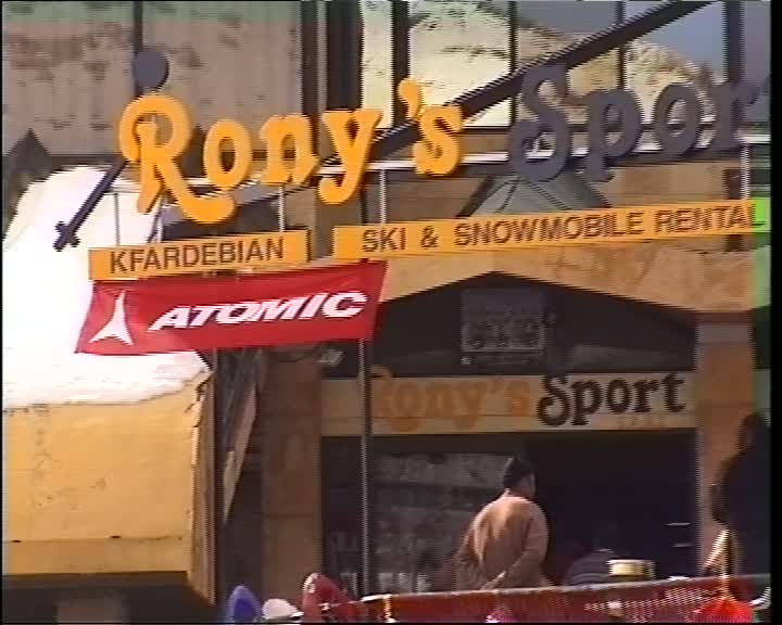

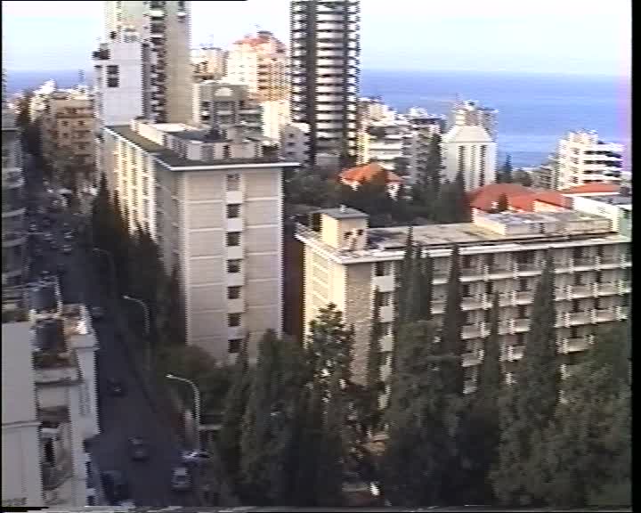

  6. Member 2Bdecided's Avatar
    Nov 2007
    It's head switching. Just blank it out. Sometimes a TBC lines it up better than you've shown, but sometimes not. Even with the best TBC it still comes out unusable.
    It might be the way the original camera recorded the tapes. Those edges were invisible on a CRT due to overscan - consumer cameras often hid a lot of evils in the overscan (e.g. like the head switching!).
    Only if it's still working properly (though a random purchase off eBay might have issues too). It's only significant if there's some misalignment between the original camera and whatever you use to play the tapes. That's quite common though (to varying degrees).
    A decent line TBC can provide a huge amount of benefit - and often all the benefit you need (unless your video capture device chokes when there's no signal). A dumb frame TBC without a decent line TBC often leaves wiggles in the video.
    That's interlacing.
    Here are your two screen shots deinterlaced (crudely):
    http://www.mediafire.com/?327h9kq19iw83xq
    http://www.mediafire.com/?sgrgetaydcmrdyx
    If VLC didn't deinterlace these at least that well when watching it live, then you didn't actually select deinterlacing. Right click, video, deinterlacing, linear.
    Or set it in the options if you want it to remember this for each video.
    With AVI, VLC might pick the wrong field order, which will cause horrible judderiness/jumpiness on movement and pans. 50/50 chance!

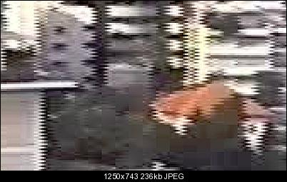

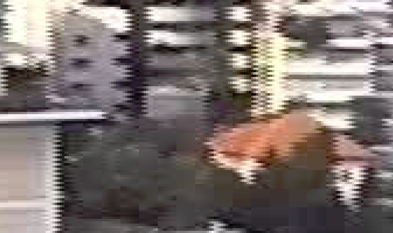

  8. Hello everyone and thanks for the quick replies.
    Firstly, Vaporeon800- the shots are from the AVI- I haven’t converted them to MPEG2 yet. The plan for MPEG2 was more to make them easier to move around/ have an informal copy my parents can watch whilst keeping the originals for remastering/ editing.
    By blocking do you mean the pixelated effect? Is that the same as the DV checkerboard pattern Lordsmurf is referring to? Regarding this, I found a thread on this forum which found that the checkerboard pattern was due to a standalone TBC (incidentally the AVT-8710 I was considering), as opposed to the line TBC/ other parts of my current setup. Is that possible in a non DV setup?
    Cornucopia- I’ve zoomed in on the photos (example posted) and am I right in presuming this is what you mean by single alternating lines?

  10. Formerly 'vaporeon800' Brad's Avatar
    Apr 2001
    Vancouver, Canada
    Not sure how you don't see the blocks in those blown-up photos. Look near the bottom right of the first one in post #8. Unless those were caused by your JPEG compression, your captures must not have been truly lossless.
  11. Member Cornucopia's Avatar
    Yeah, there's got to be DCT blocking going on there...
    OP, Your stuff is Hi8 analog. That's SD material. ALL interlaced.
    No matter which route you choose, for best In-to-Out, you should be capping and saving ALWAYS in interlace, unless you were to be doing something different like editing with other (progressive, HD, web) kind of material. Leave it in Interlace throughout including final MPEG2/DVD. Then let your DVD/BD player and/or TV do the deinterlacing/upconverting.
  12. Member 2Bdecided's Avatar
    Nov 2007
    Agreed - and I don't think it's the final JPEG compression - look at the file size vs the non-existent detail! So something is very wrong there, unless these captures are mode from lossy copies.
