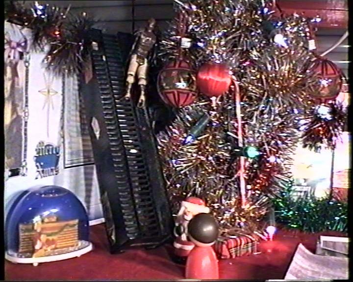

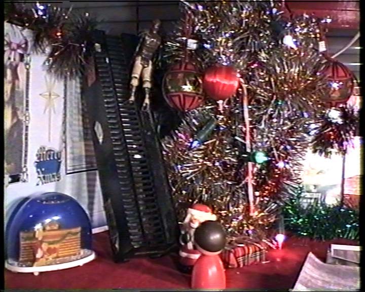

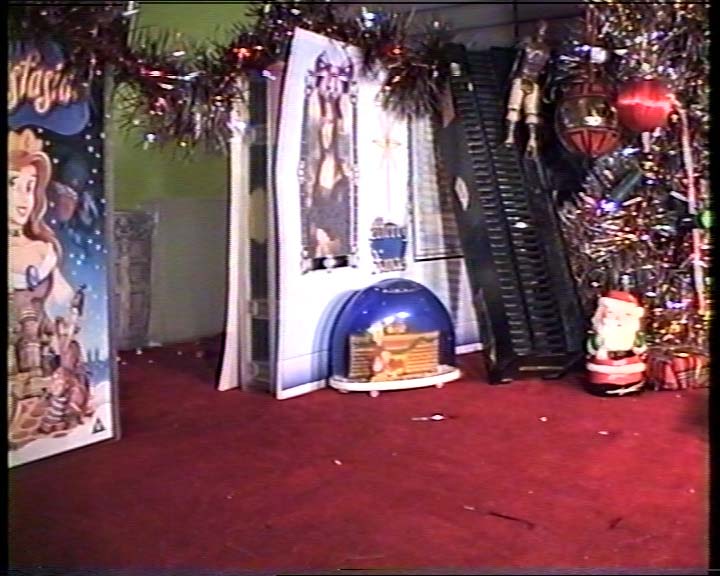

    The problem I am having is that it seems to mess with the colour and makes everything sort of greenish and hazy. The TBC-1000 doesn't do this. I am using PAL so I can't modify the hue or anything.
    I really want to capture the video as it is so I can modify colour problems in Avid afterwards. I have included samples of the problem and it can be subtle at times but enough to tick me off. Is this colour cast really a problem? I am beginning to think that maybe the MSTC is actually correcting the colours and putting them to where they should be rather than causing destruction.
    What do you guys think. Oh and I've tried all sorts of inputs and outputs. Composite seems to be brighter and fuzzier so I am sticking the Y/C. When I used Component out of the MSTC into the BlackMagic I got the picture flickering purple everyso often so I'm sticking with either Y/C or composite.
    The images marked Straight-thru is the video signal going straight to the PC from the VCR. The other is passed through the TBC-1000, brightens it up see? the last ones is going through the MSTC.
    I gave more than one example because the effect is subtle.
