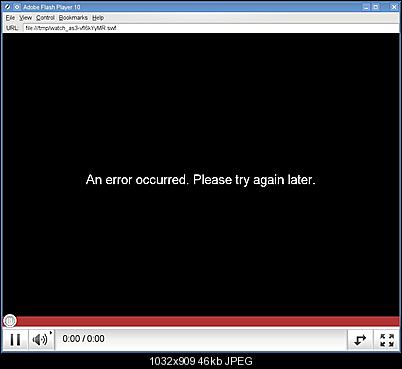

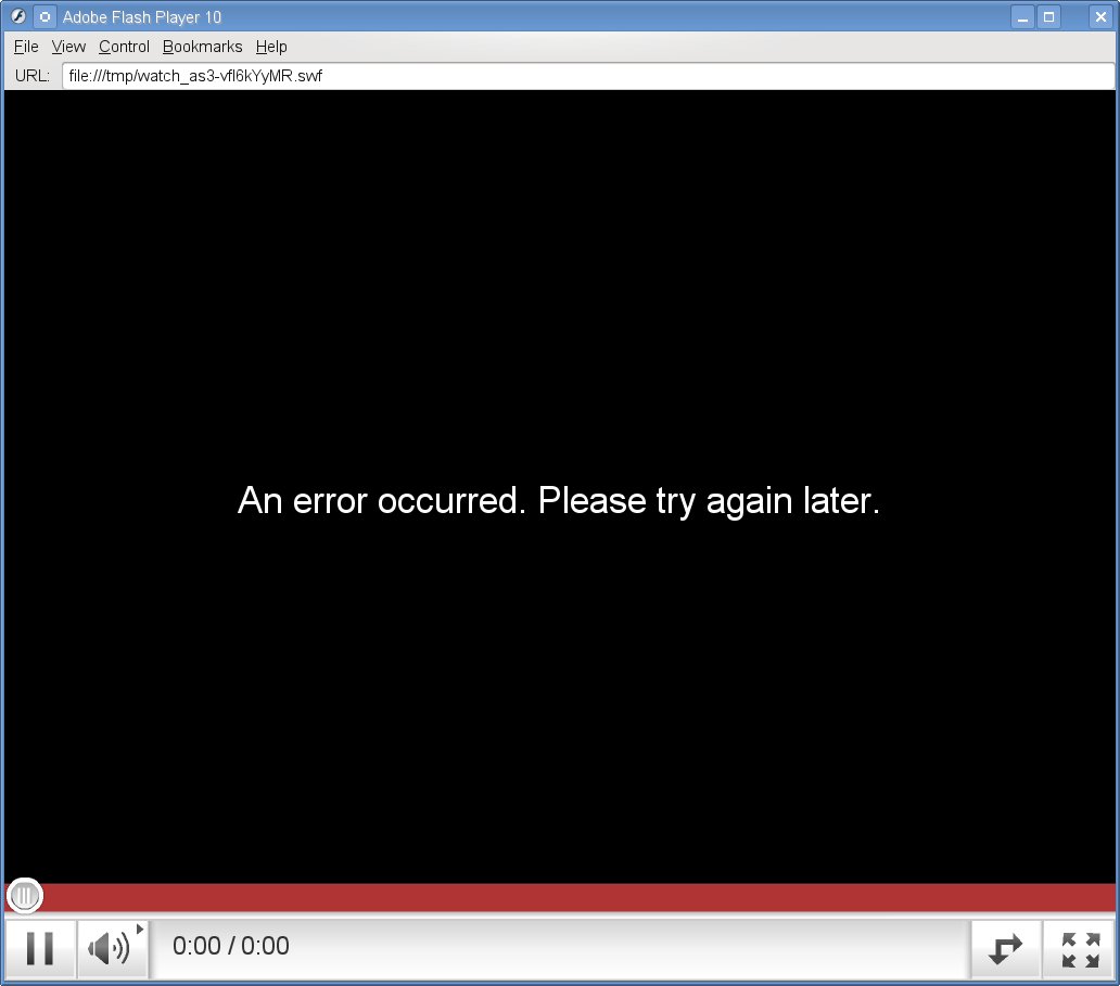

    If you're having trouble scaling the SWF file to a decent size before using screen capture software, you could try the standalone Flash player:
    http://www.adobe.com/support/flashplayer/downloads.html
    - download the 'Flash Player 10.3 Projector' program for your system
    - open a SWF file with the standalone player
    - click View->Quality->Medium Quality (to reduce CPU usage)
    - scale the Flash Player window to whatever size you want, then run your screen capture software
    *you might need to experiment with the 'Show All' and 'Zoom In' options to get the SWF file to scale properly
    Here's an example of the YouTube player enlarged:
