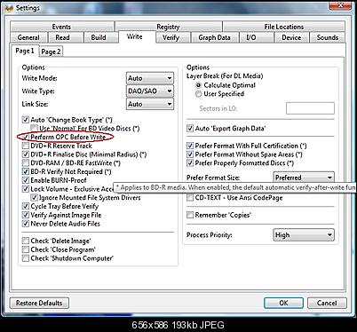

  7. Personally, I would use IMGBurn at max speed. So far, I've not had any problems with my Sony player not being able to read the dvd's that I've burned (except one recently, although it was pretty scratched before I even put it into my drive. I wish I'd known that before I used it). However, one thing that might help with crappy media (honestly, that's all I buy. So far I haven't had any problems with it yet, but I'm sure I will eventually ), is if you activate the "Perform OPC Before Write" option, which should be in the "write" tab.
    It looks like this:
    Basically, what it does is calibrate you CD drive's burning laser, and decides how much power to use. I assume that too much power can screw the disk up, while too little power will result in nothing being written. From what I gather, this option can be a great asset with low-quality media. I have yet to find any reason to not use this, aside from that fact that it adds 3-5 seconds of burning time (while possibly saving time latter). Why this option isn't enabled by default is beyond me.
