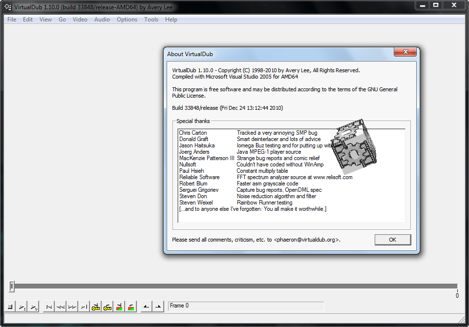

    I am attempting to open an mts file in VirtualDub 1.10.0A (x64)
    I have installed the DirectShow plugin for x64. (DShowInputDriver-0.8.zip)

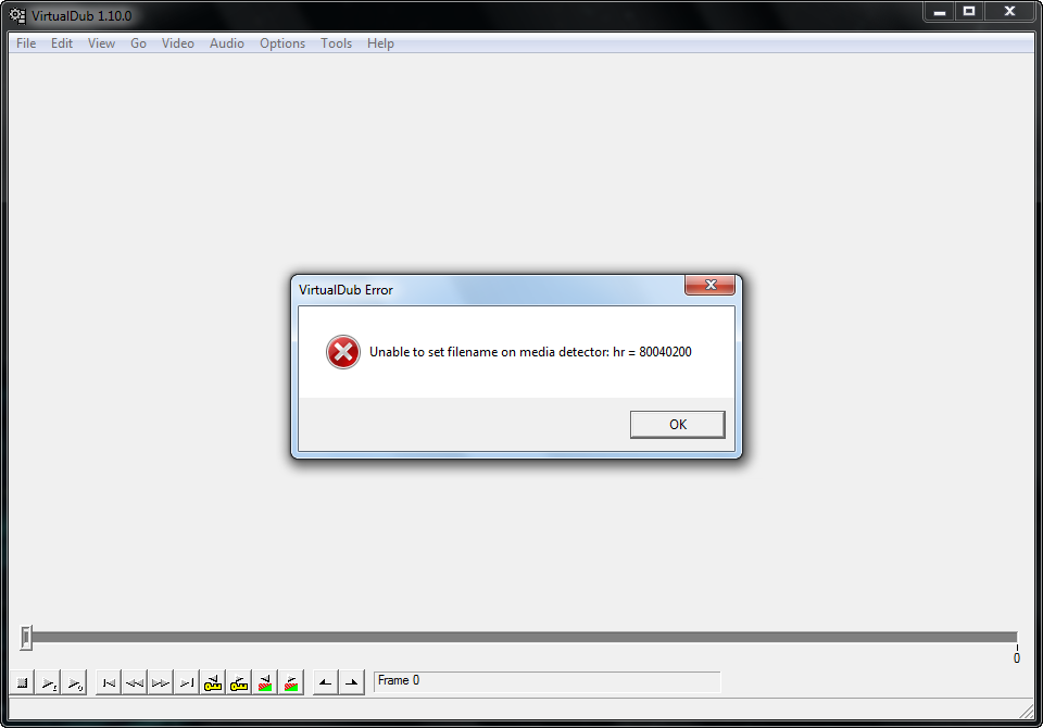

    When opening the MTS file I get. "Unable to set filename on media detector:hr=80040200"

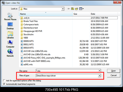

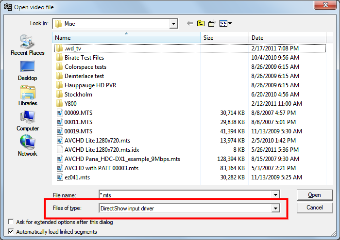

  6. Make sure VirtualDub is using the DirectShow source filter. When you open the file use the "Files of type" pulldown at the bottom of the file dialog to select "DirectShow input driver".

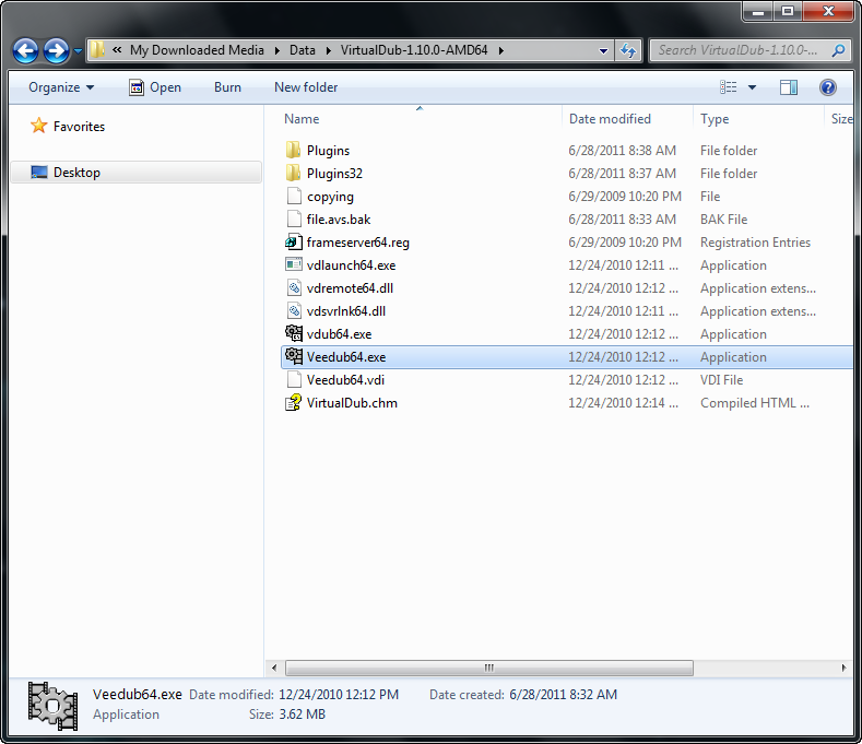

    Also be sure you are using 64 bit filters with 64 bit VirtualDub, and 32 bit filters with 32 bit VirtualDub. Don't mix the two.

    Please see my initial post for the error message that results.

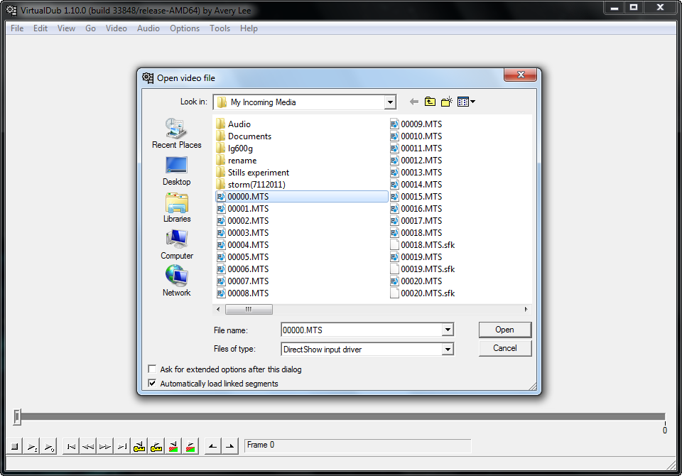

    But let me give some screen caps.
    [Attachment 8296 - Click to enlarge]
    [Attachment 8293 - Click to enlarge]
    [Attachment 8295 - Click to enlarge]
    [Attachment 8294 - Click to enlarge]

    I'd try installing Haali first. If that doesn't work install ffdshow too. Be sure to install 64 bit versions if you are using a 64 bit version of Windows and a 64 bit version of VirtualDUb. If you are running the 32 bit version of VirtualDub install the 32 bit versions.

    Click the links dude. :P (Example: Attachment 8296 = https://forum.videohelp.com/attachment.php?attachmentid=8296)

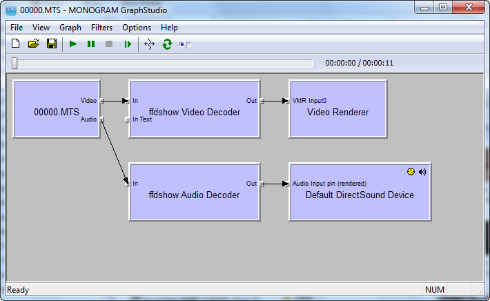

    When you render the file in graphstudio, what does the graph look like? None of your attachments show here either. If you want help and can't figure how to upload screenshots, use a 3rd party host like imageshack, imagebam, tinypic. etc....

    Graph capture attached.
    I used the tweaker and set ffdshow as the preferred. Exact same error message.
