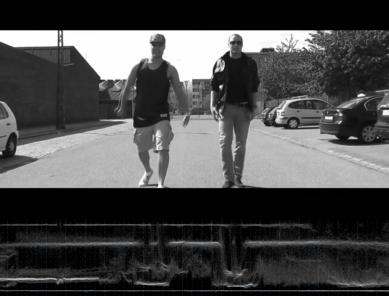

    Remember when I mentioned "shooting for compression"?
    Assuming the rest of the editing workflow is correct, most of the end compressed video quality is determined in the shooting conditions. The camera used will limit overall video quality. Those music videos were shot in a controlled studio environment against green screen with backgounds defocused and used > $25k HD cameras that weren't recompressing h.264.

    Took a quick look at your 1st video - It has a bunch of blends (ie. ghosted image or double images) , maybe you used the same workflow? (vegas blend deinterlace) or speed changes with "smart resample" enabled ?
    There are some problems with highlight clipping as well

    The 2nd part, the highlight clipping , refers to overexposures. Parts are too "white" or blown out, with no gentle rolloff. It's likely a shooting problem (most consumer cameras don't have exposure control or monitoring devices), but improper use of software can cause clipping
    This is what I mean by "blends"

    B/W is fine, that is a stylistic decision .
    What I'm referring to is the data loss or clipping . Blow outs. Things like skies lack detail. Maybe there should have been clouds there. The roll off is abrupt (if you look at the highlights in the face, they are blown, but the transition edges are too sharp, it's not gradual) .
    The other scene where this is clear is when there is water to the right of the singer, and the middle of the water is pure white, and skies are pure white. Those are blown, but the gradations are too abrupt , they are not smoooth. They go from grey to white in 1 step. This makes it look more "cheap" or "video-y"
    If you look at the attached, look at the wave form tracing where there is a hard white line - that is data loss and clipping. All luminance values above that are clipped (lost)
    Real film , or higher end cameras have more "latitude" or dynamic range. They capture more shadow detail and highlight detail with gradations and less clipping. You would see more details in the sky, the face highlights wouldn't be so delineated (they would be smoother). They look like "blobs" here. Highlights don't look like that in real life. The highlights in the water wouldn't go from light grey all the way to bright white in 1 step. If you prevent overexposure , you can often bring more detail back when you grade highlights
    When shooting try to control your exposure (using monitors for exposure, waveform, zebras - not all cameras will have them, maybe only prosumer and up, ND filters). In vegas look at you waveform monitor, histogram, vectorscope (if using color)
    Ye, the reason all of those are missing is the VideoFX applied to the video. The details are there, but not after we changed it to "sharp black and white" as requested. Can't have it all I guess
