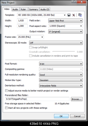

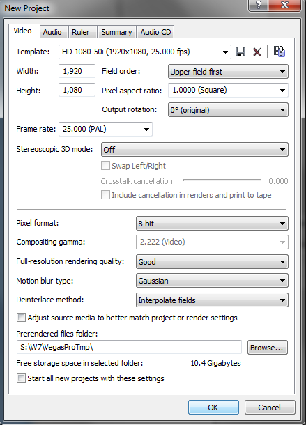

    My project settings are:
    I have done no editing to the video, no speed changes and no deinterlacing. I've not touched it for the sake of accurate results.

  10. Scan type : Interlaced
    Scan order : Top Field First
    That's your answer
    You are blend deinterlacing
    Vegas sucks for deinterlacing. The other option if you use vegas is interploate, but you will notice jaggy artifacts. But at least it won't be as blurry
    Many people resort to other programs for deinterlacing and encoding, but try "interpolate" first in the deinterlace method for the project settings

    I'm blend deinterlacing? - I turned off "Reduce interlace flicker" on the footage, and "Smart resample" is also disabled. Is there no way to get the quality desired without having to get Adobe CS4+ and Adobe Media Encoder? - Which is what I assume the guy in my before mentioned video was using. Some sort of .flv/.f4v file encoded with h.264.
  13. Try interpolate first, if you really want to learn a better method, you will have to learn how to use avisynth deinterlacers (QTGMC), and use a better encoder (x264)

  15. Originally Posted by lindenkron View Post
    yes you are blend deinterlacing. Why do you think it's blurry ? Blend= blurry
    Blend means it combines 2 adjacent fields into 1 image

  22. Member edDV's Avatar
    Mar 2004
    Northern California, USA
    There are several separate processes going on that you don't seem to grasp. All contribute to end quality. I'll attempt to overview them.
    1. Camera source - You have given no camera details but it appears to be 1920x1080 25i AVCHD.
    2. Shooting conditions - Lighting, camera stabilization and subject motion are critical to ultimate encode quality. In Film class they would call this "shooting for compression".
    3. Editor project settings - As said above, in the typical case you would match the camera format. Current CS5 and Vegas 10 versions have 1920x1080 25i AVCHD templates and h.264/AC3 codec support. CS3 does not so you would set project to 1920x1080 25i upper field first and hope for the best.
    4. Deinterlace - You are shooting interlace video and Youtube displays progressive. Deinterlace contributes heavily to the end quality. Experts use different methods for different types of video. Vegas allows three (no deinterlace, blend, interpolate). Selection is made in project settings. If there is any motion beyond a talking head, use interpolate. As said both Premiere and Vegas (also Final Cut) have mediocre deinterlace quality.
    5. Frame rate - frame rate conversion will cause interpolation blurring similar to deinterlace. Better keep it 25 fps and let Youtube handle it since they are going to re-encode to their requirements anyway. Others may have opinions on 25 fps strategy for Youtube.
    6. Resize - Above you resized to 1280x720. Resizing interlace video is a tricky optimization. Again Premiere and Vegas do a deinterlace followed by frame size interpolation. This gives a so so result. Experts would deinterlace and resize in other programs.
    7. Encoding - This gets tricky because Youtube is going to re-encode your work in most cases. Premiere and Vegas control deinterlace, frame rate, frame size and encoding all in the export encoding menu. The main encoding choices will be codec, interlace vs progressive and bit rate. Recent versions offer templates for internet upload. IMO and this is debatable, since Youtube is going to re-encode anyway, it is better to max the bit rate that you send them (limited by maximum file size allowed) to get the best re-encode at Youtube.
    Those are the big picture issues. Good luck.

    1. I appreciate you taking the time to write that up for me edDV, I really do. I'm most likely getting the Canon 550D (T2i) in two weeks and then the i/p difference won't be a problem. I honestly didn't realise that the camera (I'm borrowing one) I have right now was shooting in 1080i and not 1080p. And the reason I've given no camera details, is because, as mentioned, it's not my camera/video recorder so I hardly know anything about it .
    3. There's no standard for 25i AVCHD in the templates on Vegas Pro 10.0.
    I checked the settings changed when picking 1920x1080-60i, 10 Mbps video stream, and it appeared that the only thing that changed was the "Field order:" that changed to "Upper field first"
    So I went ahead and made my own settings and changed that.
    Which resulted in me receiving this message.
    4. I changed the Deinterlace method to Interpolate fields, but I've yet to be able to try it out due to that error.
    6. What other programs would they resize in?
    7. That seems like a smart way to see it, but I still need to manage to optimize the picture so it looks decent - even if not caring about file size to some extend - any suggestions?
    Thanks!
  24. Originally Posted by lindenkron View Post
    25i and 50i denote the same thing , just different naming conventions. They both mean 50 fields per second or 25 frames per second
    Use the 1080-50i preset
    Don't use the 60i preset. 50i=>60i speed change will introduce blended frames (blurry) when "smart resample" is on, and duplicate frames (choppy playback) when "smart resample" is off. When the settings match, everything works . So use the matched settings as your source.
    Not sure about the other errors, but try using the proper project settings first.

    Well that had an interesting effect...
    Using 1080-50i and then start rendering crashed my Sony Vegas on 0% (I managed to see the render bar). Hmm.
  26. Reboot your system, reload the project, and try the mainconcept AVC export and see if it makes a difference
    Is your computer stable ? Is it overclocked ? Have you check your memory integrity ? System temps ?
    Quite a few people on various forums seem to be finding vegas 10 unstable.
    If your goal was youtube, you should not be selecting upper field first in the export settings (you want to select progressive, so vegas will apply a deinterlace) . You should use CABAC instead of CAVLC (higher quality and compression) , profile high instead of baseline as well (baseline imposes more limitations on what features a h264 encoder can use, so you end up with lower quality at a given bitrate)
  27. Member edDV's Avatar
    Mar 2004
    Vegas Pro 10 project setting for AVCHD
    http://www.kiva.org/about
  28. Member
    Jun 2011
    Denmark
    Those were the settings I used yes
    I'll try rebooting - It's not really a "Project" it's just the same movie clip I use for testing. Just so I know it's not a VideoFX flaw or what not. Once the quality is how I want it, I'll advance from there - just to avoid complications later on.
    My computer is new, it's overclocked from the manufacturer, I've done no handyman job on it myself. How do one go about checking memory integrity and system temps? Don't know if you have seen the specifications for my rig, but I believe it should be able to handle this :P. i7 core, 3.4ghz, 8gb ddr3 1600 mhz ram - should be plenty.
    It would seem that Vegas is a tad unstable ye, but it must be something conflicting because it only does it on specific things. Such as trying to pull off a 50i render. I'll make sure the things set are set and try again after reboot .
    Thanks again both, really appreciate it.
    Brb 2 mins!
