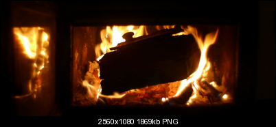

    In the clip, the fireplace dimensions are 39cm x 20 cm

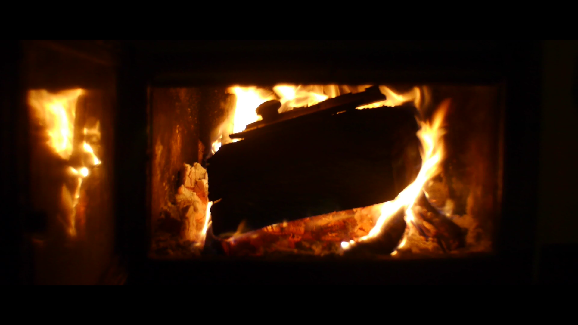

    In the mean time, check if this looks ok
    The active image area is resized to 1920x816 which gives 2.3529 AR, letterboxed with 132px top and bottom . Is it not wide enough ? or too wide ? Once you figure out the values you want, then you can use pad and scale in ffmpeg
    So an example windows batch script that encodes all the MTS files in a folder using ffmpeg and those letterbox values that encodes to mpeg2, with audio copied, into a transport stream. The ouput files will have the same name, but .m2ts extension
    for %%a in ("*.mts") do ffmpeg -i %%a -vcodec mpeg2video -qscale 4 -s 1920x816 -vf pad=1920:1080:0:132 -acodec copy -f mpegts %%~na.m2ts
    pause
    If you want it wider or narrower just adjust the values and compensate with the pad values. I arbitrarily selected qscale 4, but if want higher quality, larger filesizes use a lower value like 1 or 2. If you want lower quality, use higher values

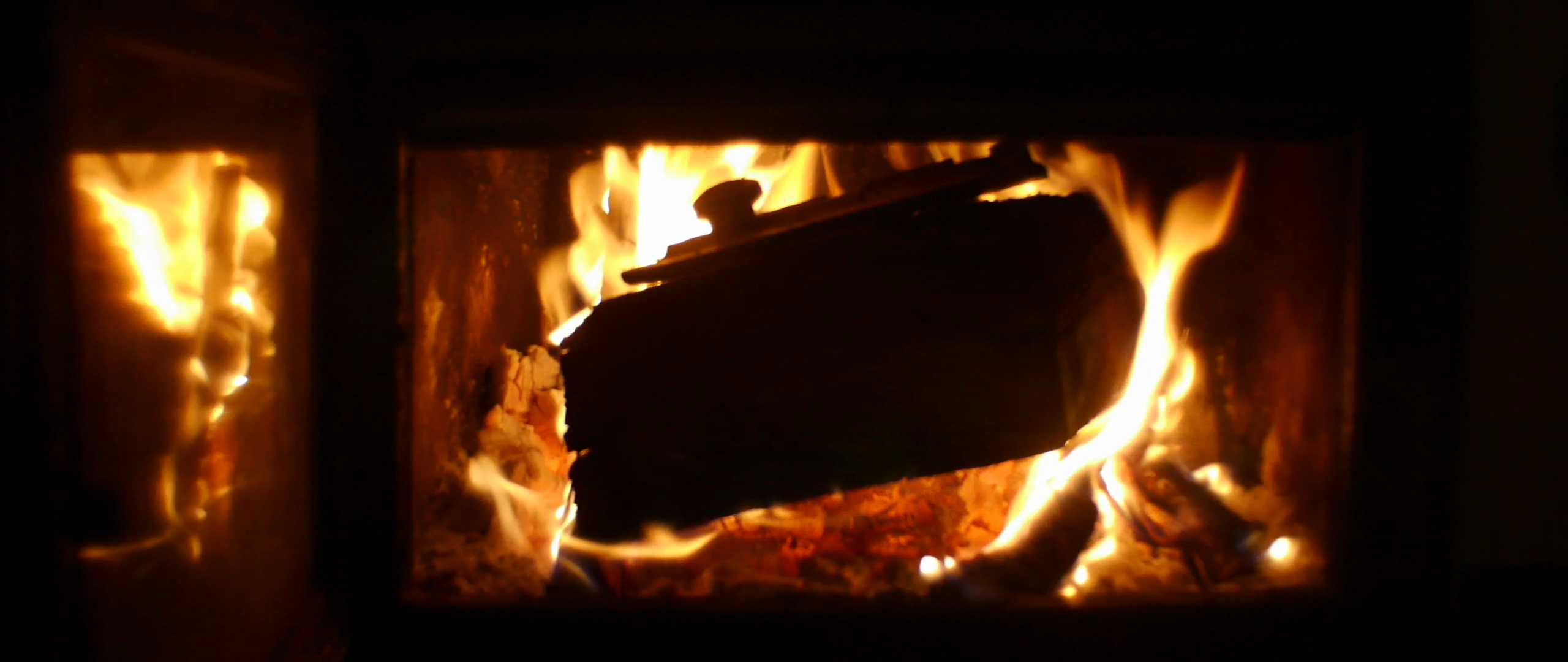

    if you go into vlc settings(all) and change the monitor pixel aspect ratio to 0.75 it will display all video as 3:4. the sample plays fine with a q6600 cpu.
