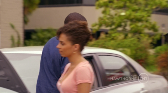

    I was hoping someone might be able to help me out. In trying to encode this clip of mine i have chroma issues coming through. The source is (4MB file): http://ge.tt/8XxPZR5
    Using an ordinary TFM().TDecimate() i get a correct IVTC, but the result is a red color bleed: http://i56.tinypic.com/98vatd.png
    Using a TFM(chroma=true).TDecimate() the red color bleed goes but then i get the grey (lack of colour): http://i54.tinypic.com/15hlset.png
    Any assistance would be greatly appreciated. I am looking not only for a specific fix, but also a fix in general that can be applied arbitrarily to auto fix such issues, if such a fix is out there.
    Thanks in advance.
  2. I can't reproduce your issues on your sample clip, chroma looks fine here on the same frame as in your screenshots
  3. Using an ordinary TFM().TDecimate() i get a correct IVTC, but the result is a red color bleed: http://i56.tinypic.com/98vatd.png
    Perhaps your looking at the wrong frame, the relevant frame on the resulting xvid is frame 22 (on the source its frame 12950)
