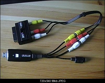

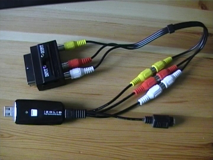

    Here's the device I use for capturing:
Name:	Zolid DVD Maker.jpg
    The Zolid High Speed DVD Maker. It's a cheap USB thing but has served me well so far. It turns out, though, that it's impossible to change the volume of the audio that passes through this thing. You get two options: no audio, and full blast. If anyone has a way to give me some decent control over the volume on this device, that would solve the problem right here. Otherwise, well, read on.
