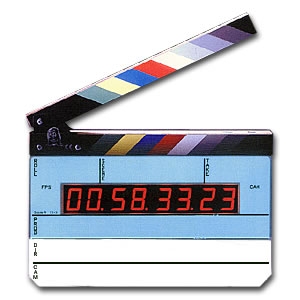

BTW: Pro separate sound recording uses SMPTE time code to sync the audio to video. That is why the film clapboards show time code.
