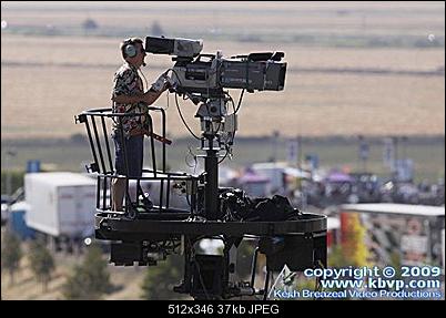

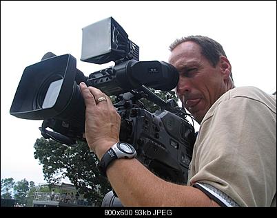

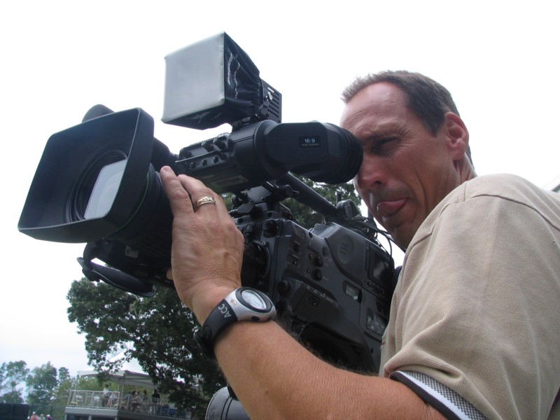

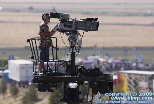

    What is your budget?
    The minimum 3CCD 720p/60 cam appropriate to the task is the JVC GY-HM100U. For car racing, you would do better with the larger cams that take long TV zoom lenses.

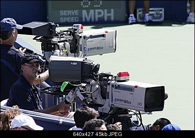

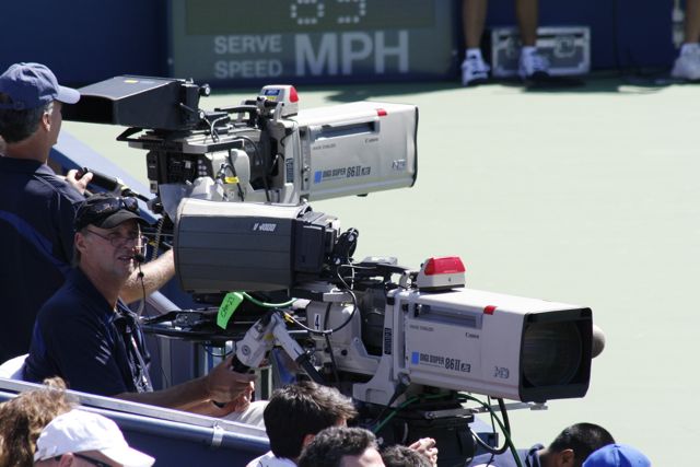

    This is network tennis but shows the size of the lens* vs the camera. Not saying this is what you can buy or need but indicates what to strive for to get the job done. Understand the fast action need.
    *Canon in this case.

  7. Well, we underdstand the budget limitations we have. Most of our distribution will be on our website as well as selling Dvd's to the drivers that are in the race. Quality is not the number one focus. Capturing the event and telling the story is the main focus. Obviously we want to look as good as possible, but with the equipment we start with I have to rely on well shot footage and a couple of editing techniques to to give it more of a film look. We hope within 2 years we can upgrade to decent 3ccd cams.
    Thanks for all the advice, and yes it would be cool to have some of the cams shown above.
