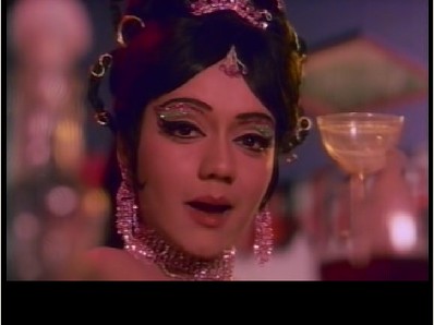

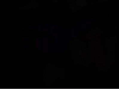

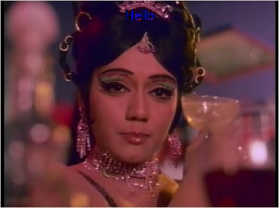

    How to do it? It depends on how you create your subtitles. I believe SubtitleCreator can create them and you can dictate the size of the background and make it opaque instead of it being transparent, as is usual. So I think it can be done all in one step. Maybe SubtitleWorkshop also. I don't know as I don't use those programs. I do it after the fact using DVDSubEdit. I created a topsub in Substation Alpha, one that lasted throughout the entire video, converted it to SST in MaestroSBT, and then authored using Muxman. I opened the resulting DVD in DVDSubEdit (first picture), turned the colors to black and made the background opaque (2nd picture) and then moved the subs down to near the bottom (3rd picture):
