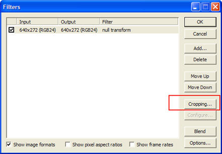

  27. add a null transform , or any filter (video=>filters) , then the crop button will show up
  28. --
  29. see the screenshot above: add "null transform"
    null transform does nothing. This is only so the cropping button gets activated (it's highlighted in the red box). Push that button
